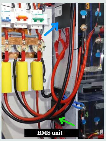

Like you, I have favourable views of the Active Balancer units from JiKong (JK).
BMSunits
The lower box (green arrow) is a 200A JK BMS, and the upper battery has just an Active Balancer (blue arrow).
