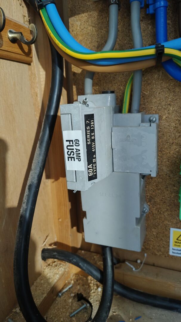

Just to quickly update you. This is unfortunate and may happen to other people so it's worth sharing.
The electrician came and said that they had to visit my neighbour's property to establish whether our power supply was linked.
However, my neighbour was not in and hence I could not have this assessment done.
My neighbour then said that he cannot be available during the week but UKPN does not run visits over the weekend.
Hence, they have now sent a formal card to my neighbour to ask for availability.
It turns out they can do this a maximum of three times, and they will then have to come with the bailiff.
Of course, I don't want this to happen but I also feel between a rock and a hard place.
I hope at the end of this ordeal I will have a fully functional system...

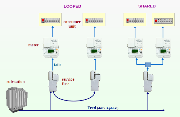

Posts: 3503
Your energy: 39 kWh
We assume that 'electrician' was a UKPN engineer @eliuccio
I wonder what triggered that visit to your neighbour.
Perhaps they've put in an application for Low Carbon Technology (heat-pump or EV Charger).
There are two categories of domestic supply which the DNOs are working to upgrade: Looped and Shared
LoopShared
It might not be essential for the DNO to visit.
Your neighbour could take a photo of their Service Fuse, ensuring that it shows the cabling which enters and leaves it.
If they email that to the DNO, together with the reference number on the card, then it might show enough to assess whether the supply is looped.
(@batpred)
Posts: 1252
Your energy: 20 kWh
Posted by: @transparent
UKPN would soon avoid that visit..
