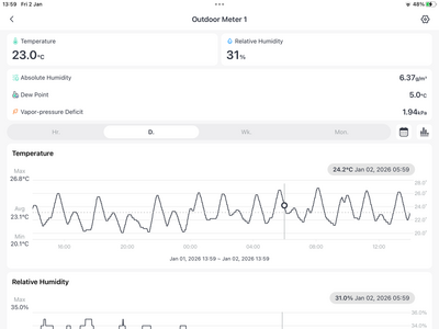

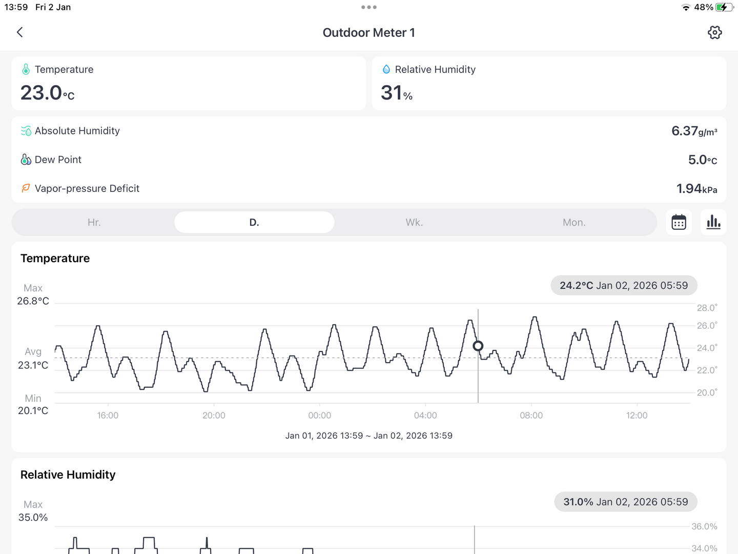

It’s not 2 minutes, it heats up for 40-50 minutes, at nearly full blast, then stops completely as the homely registers a downstairs temp above target. This is the output from the radiator upstairs, on until just before it peaks and then off. Start 50 mins, stop 40 mins, start 50 mins, stop 40 mins, 24 hours a day. It doesn’t modulate.

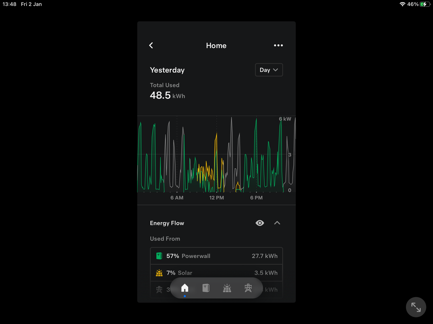

Maybe the better way to visualise it is my house electrical demand. Ramps right up to full or nearly full heat pump output, then stops dead.

@papahuhu sorry - confusing info in previous posts
Anyway upstairs rads aren't getting to anything like the flow temp it seems so that needs to be fixed before any conclusions can be drawn about rad sizing.
