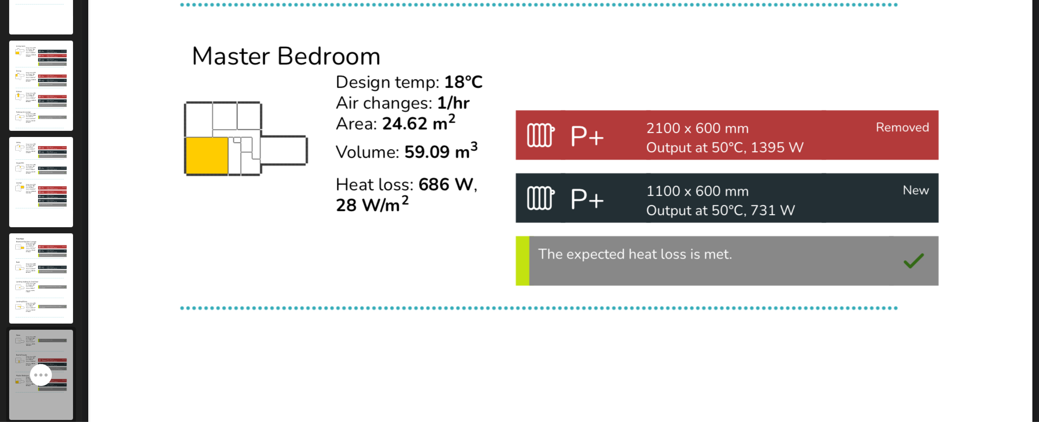

thanks, yes it seemed mad to me. An exert from the heat loss report for one of the rooms is below.

Total and complete madness!  Better would have been to leave the upstairs rads, make the downstairs ones bigger if there is room, and drop FT, or just leave the upstairs rads and turn them down.
Nothing obviously wrong about the assumptions although 28W/sq m suggests pretty good insulation assumed.  It might be worth interrogating the materials/U values assumed.  Is there any chance you have cavity walls that aren't filled at the top (a common problem apparently).
Its just possible that some rebalancing will fix the problem, but not particularly likely.  Just don't let them increase the FT to fix it because it will cost you.  Rads are cheap and changing them easy, so I hope it wont be too difficult to persuade them just to swap it back.  TBH I'm surprised they are bothering to do another survey, for the cost they could swap two or three rads and still have change and the fact your rooms are cold tells them more than a survey ever can, because its a real measurement not GIGO what-iffery!

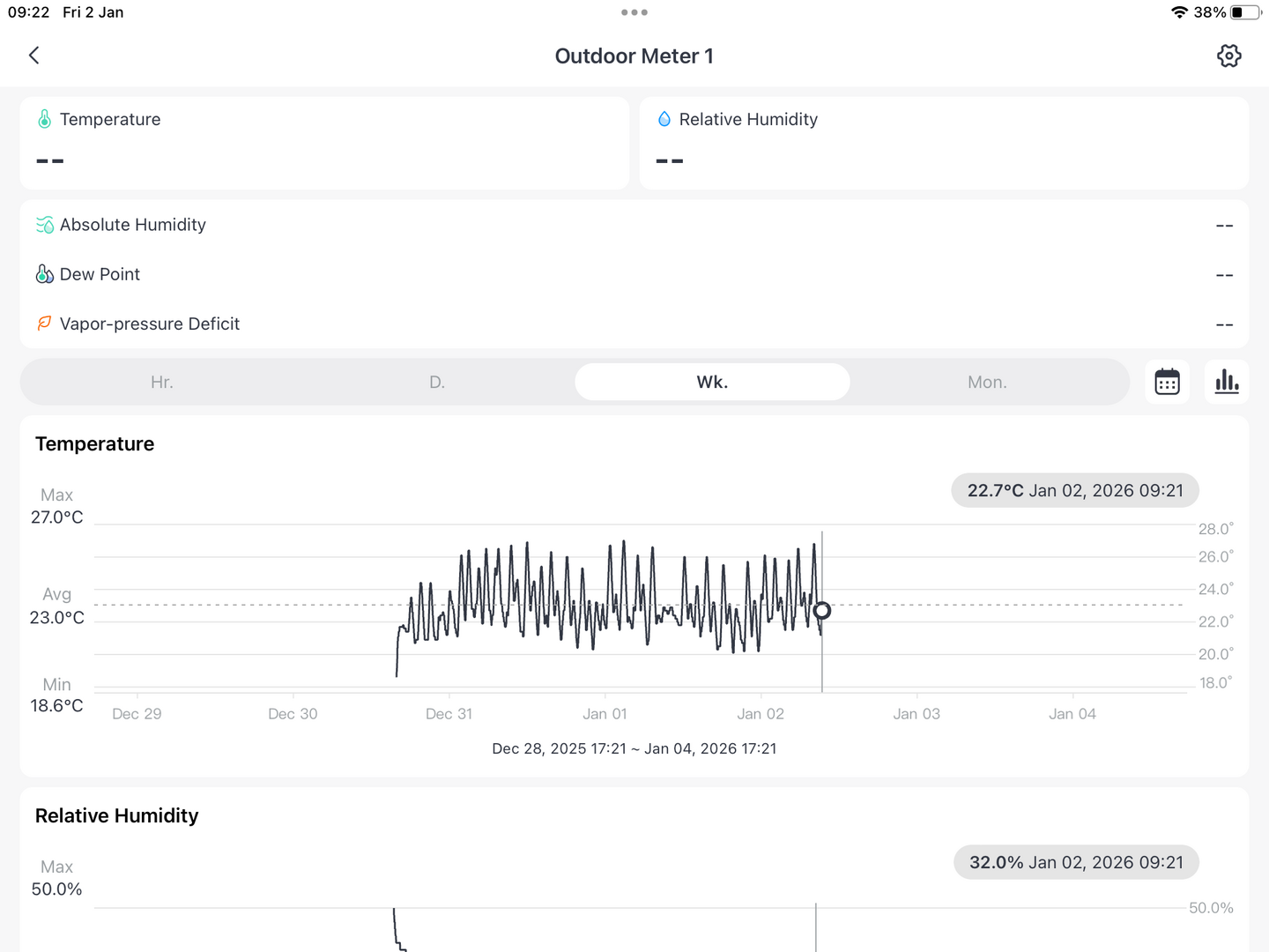

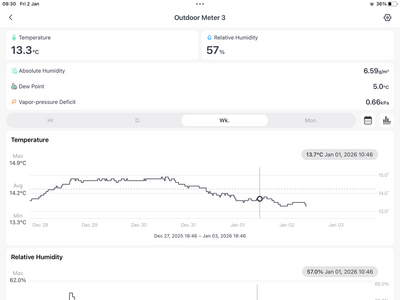

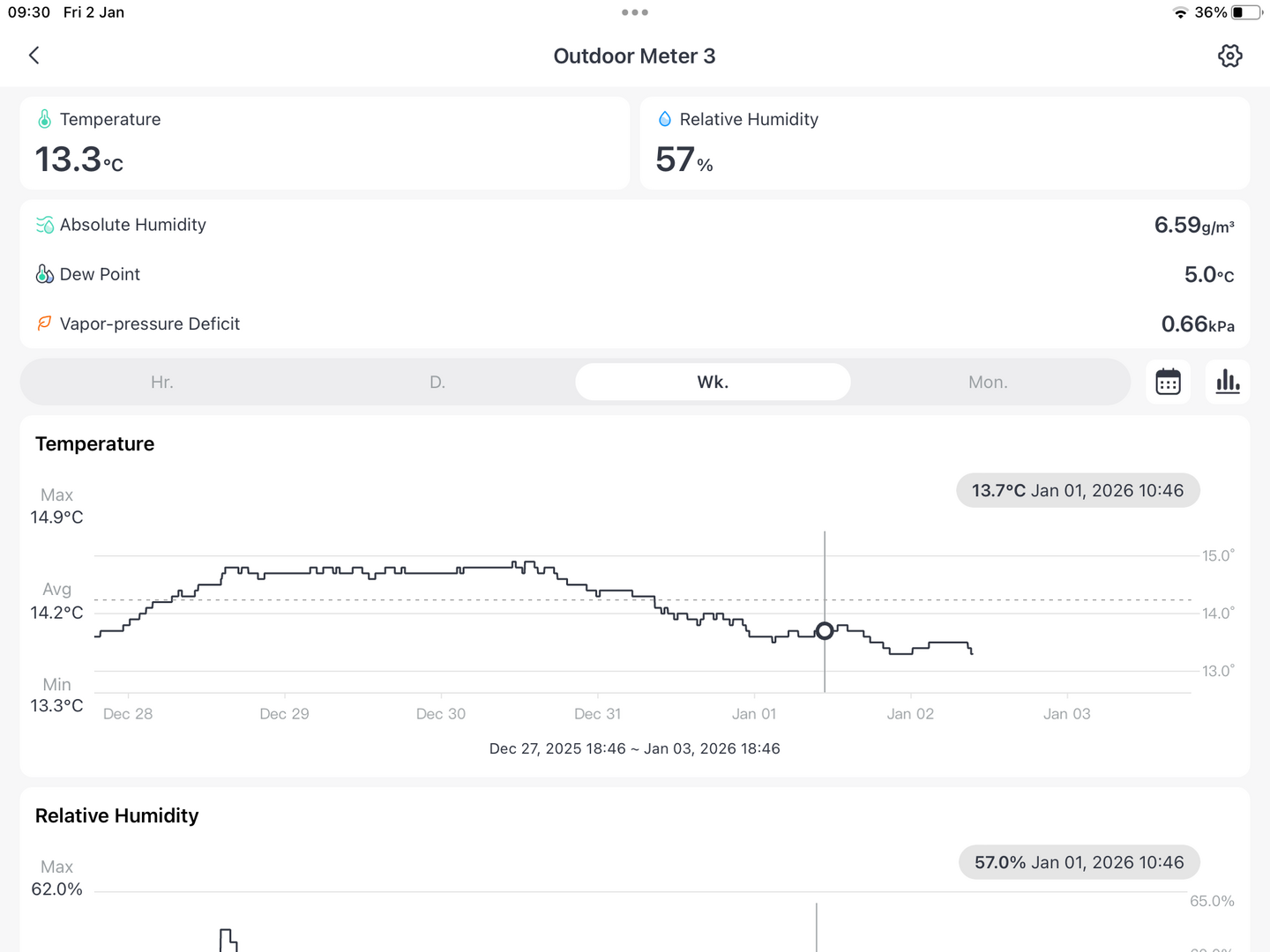

its weird. It’s -1.5C outside, I’ve been monitoring the temp of the radiator (not the room) and it’s only running at about 24 C. The current outlet temp on the heat pump is 38C, I would have expected more of the heat output to be reaching the radiator. Earlier today the heat pump was running at 26C output, but no big difference in radiator temp between 26c or 38c output.
The corresponding room temp is

I’ve been comparing radiator temp and the upstairs and downstairs are within 0.3C of each other. A 33C heat pump outlet temp was resulting in radiators at central location of 25.8.
So they are getting similar flow and receiving similar heat. I just think they are too small. It doesn’t help that the homely node keeps turning the heat pump off. It runs for about 50 mins, reaches the set point temp and turns off for about 40 minutes until the temp drops below the set point. On/off/on/off, 24 hrs a day.
