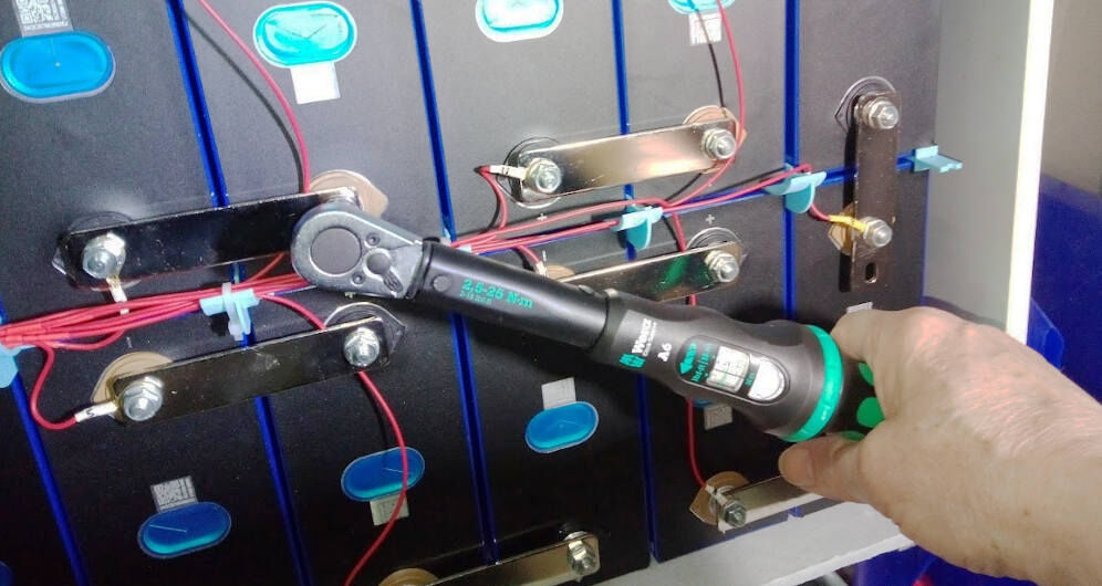

Posted by: @editor[...] this is where my DIY inability hampers me... would definitely consider the cheapo route and install myself, but don't have the skills
If only there was some sort of online help-forum where people could offer you advice 😉
Just how do you think the rest of us worked out how to build/install a battery?!
Domestic electricians aren't necessarily in a better position than you.
Except they do start by having a selection of tools and a multimeter.
The only point at which you need a qualified electrician is the final step to connect the inverter back to your consumer unit.
For everything else, you'd be working below 75v and following what others post here.
That includes being told which tools or additional components you need, and where to get them from.
Think of it as a New Year's Resolution, and start a new topic so the whole world can follow your progress.
