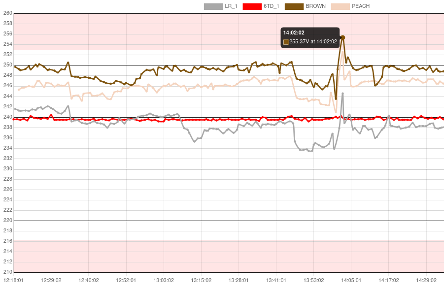

This timeline from May'24 shows three Grid Monitors, Brown, Peach and Grey, at different locations about 5km apart.
Ignore the red-line. It's the output from an off-grid storage-inverter.
The underlying voltage fluctuations are normal, and due to regional supply & demand at 33kV and above.
Line voltages for the location of the Brown Monitor are above the other two because of high levels of local (rooftop) solar generation.
When the regional generation sources are changed by the DNO at 14:00, the voltage at the Brown location rise above the statutory 230v + 10% (253v).
Consequently, solar inverters in the area detect the over-voltage and cease export, causing a sudden voltage drop.
Every household with a solar inverter connected to substations near that location is no longer exporting... whilst householders remain oblivious.
This demonstrates one of the many reasons why DNOs don't want high levels of export, especially from single-phase properties.
