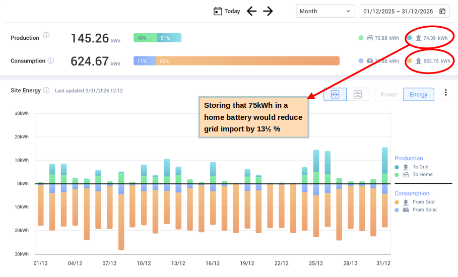

Full year 2025 figures per the Sunsynk app are 4,326kWh PV generation and 1,594kWh of export. The system was installed in December 2022, and the 2023 PV generation of 4,425kWh remains the best figure achieved, but I'm at 97.8% of that total and I have a general expectation that the system will become less efficient with age, so it could be that plus weather variation that are potential causes. We have tree shading in the garden due to mature trees with TPO's on them, so the production will always be compromised to an extent.
The export figure of 1,594kWh is (only just) the highest one yet, vs 1,549kWh reported in 2023. Octopus have paid me for 1,710.94kWh of export, so Sunsynk seems to be under-reporting the figure, presumably as it doesn't register the background trickle of constant export that I believe is a protection built into the system, but it at least provides me with a consistent comparative figure.
There's no forced discharging built into our configuration. We simply charge the batteries overnight on the Intelligent Go 7p rate and let the system discharge the excess during the day at 15p when the batteries are full from solar recharging.
@transparent, excellent observation... my issue with batteries is still the massive capital expense... I'm still struggling with the maths. Maybe in the next house when we have a smart meter.
You could relocate a storage battery to a new house if you wanted to!
