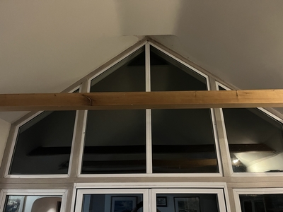

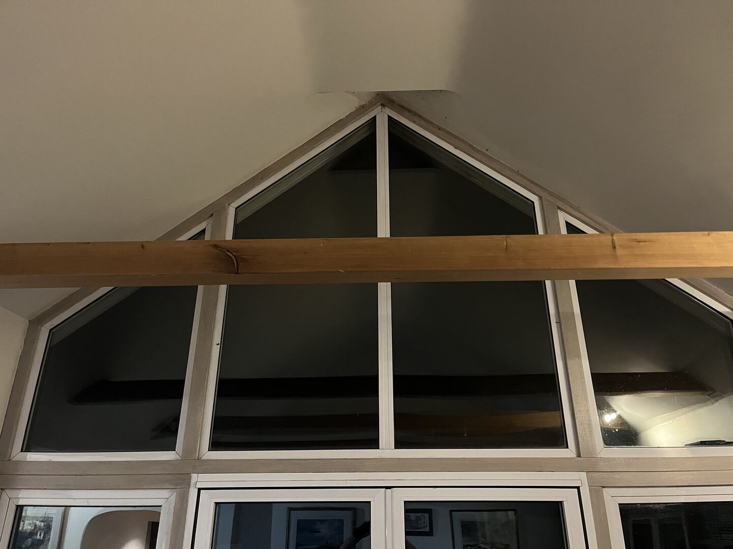

Whilst we're talking about blinds, does anyone have any good and practical ideas for some roller blinds to cope with glazing that goes up into the eaves? Ideally, I'd want to deal with above the french doors as one zone and then separate zones for each french door and each window beside the french doors.
No idea what shaped solutions are available, though, motorised or not. Don't want to spend a fortune, so if it's not cost effective we'll no doubt just leave as is.
