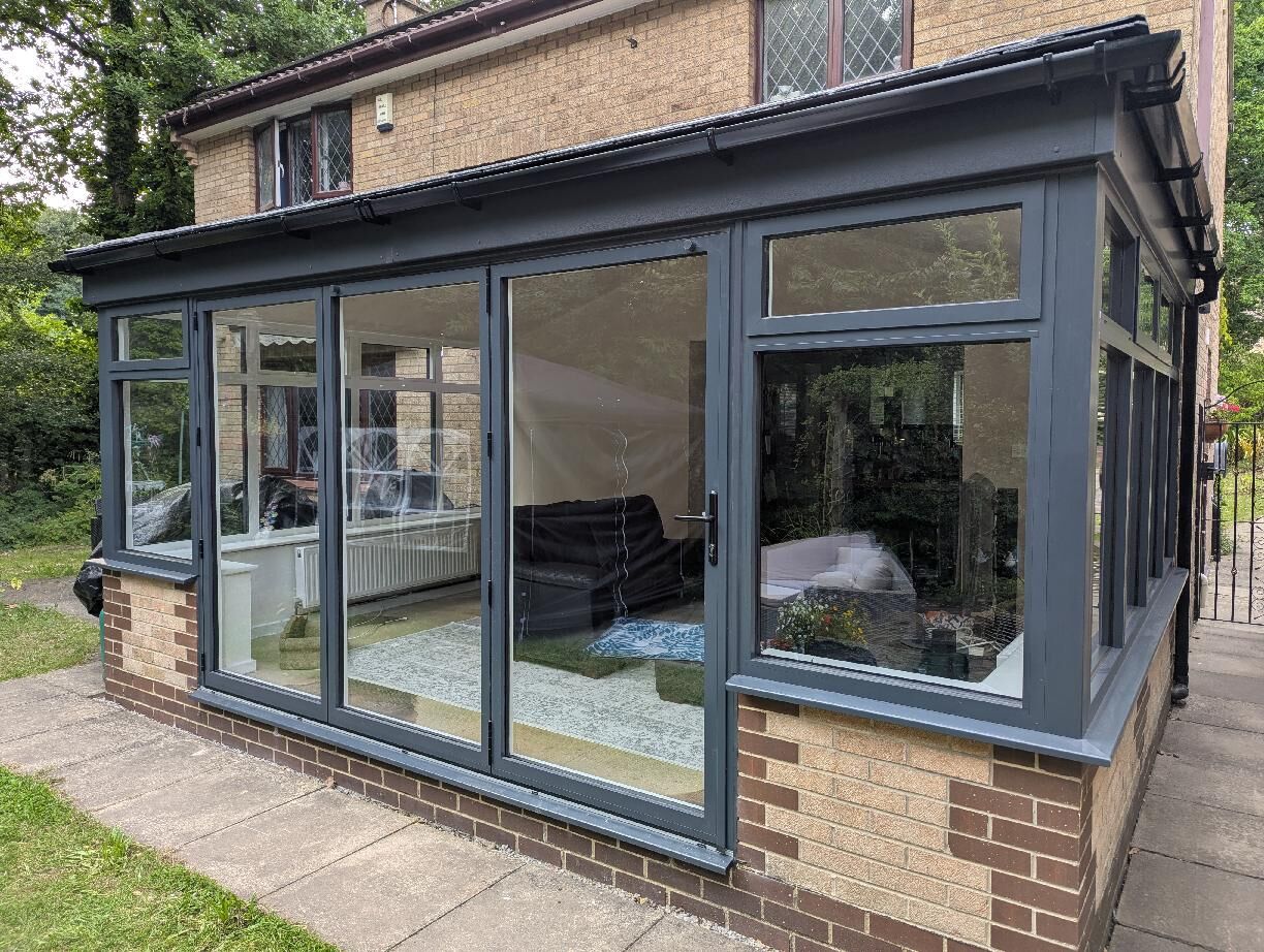

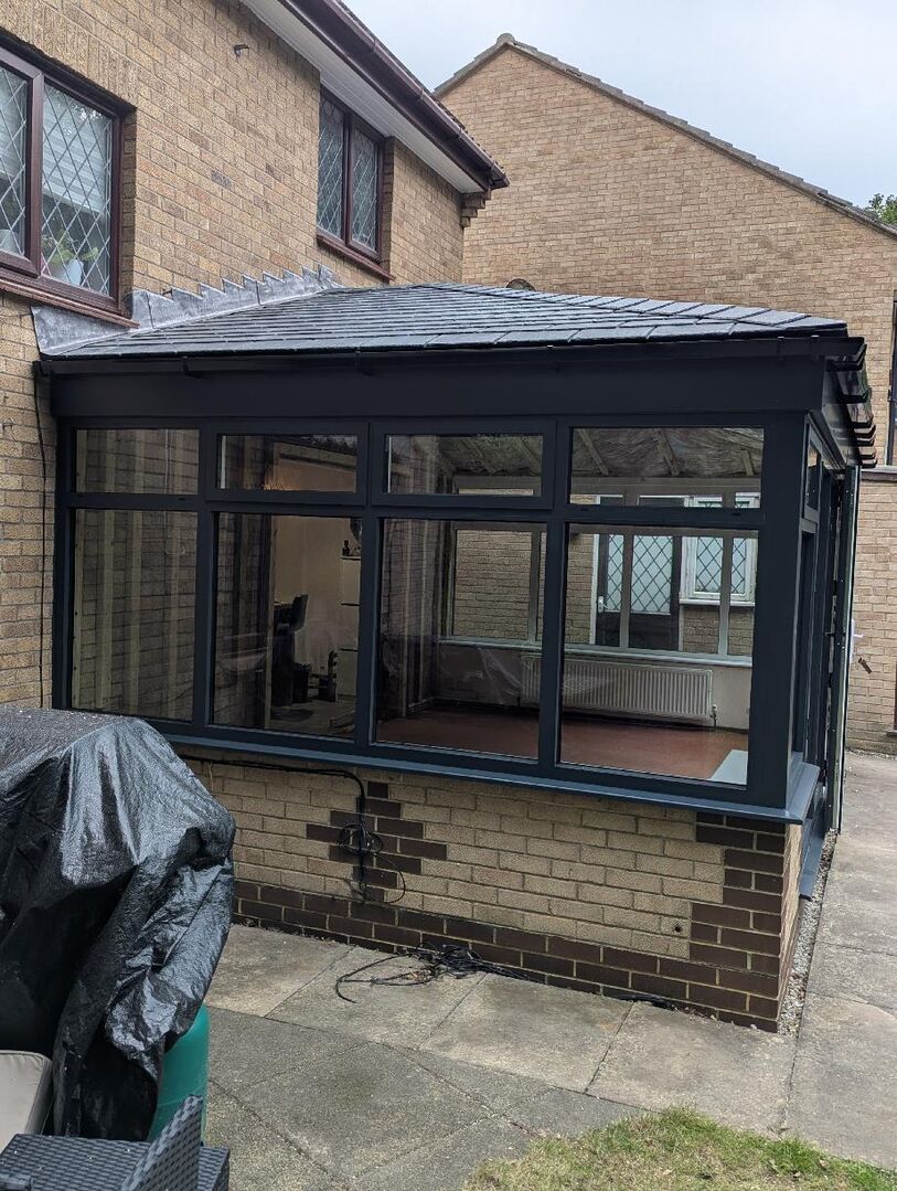

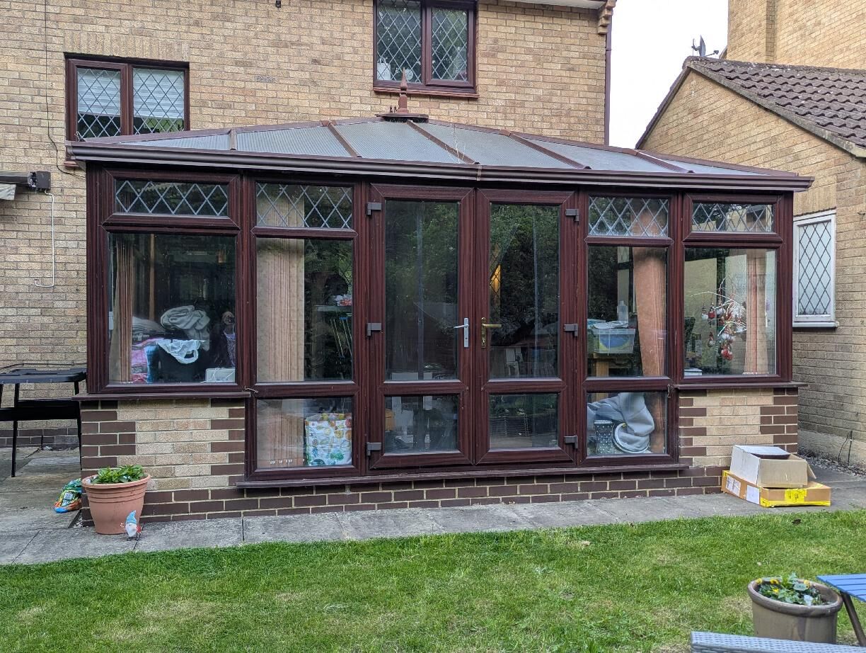

Prior to doing any further updates on this thread, it's worth clarifying the situation with the conservatory saga which dominated the quotation process, as I've made reference to the fact that it got upgraded subsequent to the installation, which is the 'wrong order' than you'd ideally choose to do this.
The conservatory, even after upgrade, is still likely to be relevant to the overall CoP achievable in the house, but it's easier for a knowledgeable reader to form their own views if they can visualise it.

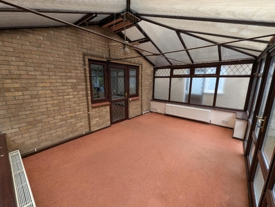

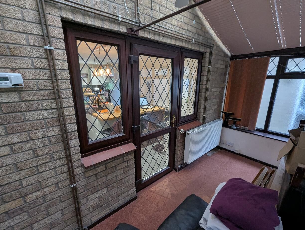

So just to recap, when we commenced the quotation process in February we had no idea that the conservatory would prove to be such a challenge. It was a 1997 extension added by the previous owners and had been connected to the wet heating system via pipework running through the floor of an upstairs bedroom off the radiator in there. It was controlled by a separate thermostat to the main house, which we subsequently discovered would have been a requirement of the building regs at the time, as was the fact that the external doors and windows remained in place when it was built to separate it from the main house.
The above photos show the external and internal layout at the time (the internal pipework had been covered up prior to this, but we exposed it ahead of the work commencing).
During first heat loss survey, done by Octopus, the surveyor mentioned the conservatory as soon as he walked through the door. To his surprise, rather than exclude it, he calculated that the two radiators in there were recovering about 97% of the heat loss, and so was able to build it into his design.
Others, as we would subsequently discover, automatically ruled the conservatory out of consideration in the design and wanted to disconnect it, but this seemed counter-intuitive to do so, and then have to find an additional heating solution for that room alongside a new heat pump. We worked with various designs which included it, accepting that there would be a compromise on performance in doing so as the heat pump would have to work harder with the room included.

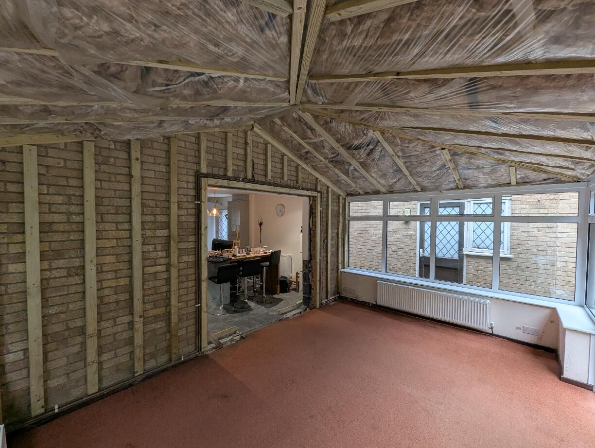

However, this also triggered us considering what to do about the conservatory longer-term, so as we were working on the heat pump quotations we started researching methods to improve the heat loss within that room. This very quickly ruled out any of the cheaper 'insulate an existing roof' propositions, as the size and existing structure wouldn't have supported the weight of such, so we moved on to looking at replacing doors, windows and roof. We learned from this that, if the job was done with appropriate building regs certification, we could properly convert the conservatory into an 'official' room within the house and lose the requirement for the external doors and windows to remain.
As suspected, the first couple of quotes we got for this work were prohibitive, but we then saw an advertisement for a local company offering a summer discount on work booked to commence within the next 4 weeks (essentially to cover one of their natural quiet periods). Naturally sceptical of such a 'deal' we got them to do a survey, and the quote received, which was several thousand pounds less than any of the others, along with the professionalism of the surveyor in answering queries nudged us into having to seriously consider it. After an evening of trawling Trustpilot and Facebook reviews, and doing due diligence on the company financials, we committed to the work on the final day of their summer offer, for an installation to commence approximately one month after the imminent heat pump installation date.
I had already done some calculations using the existing heat loss data to see what potential impact such a change would have on the outcome, and the conclusion was that amending the u-value figures in the relevant areas of the calculation would result in a heat loss reduction of, from memory, around 750W, which wasn't enough for us to need to size down from the 10kW Ecodan. The timing also allowed us to speak to the heat pump installation team to ask them to re-site the existing radiator under one of the external windows, as part of the wall on which it was sited was going to be removed. This was a relatively simple job for them and we only incurred an additional charge, at cost, for the new radiator, as this hadn't been originally factored as one requiring replacement. The photo below shows the conservatory on the weekend prior to the conservatory rebuild, after we'd cleared it out ahead of the job, with the re-sited radiator in place.

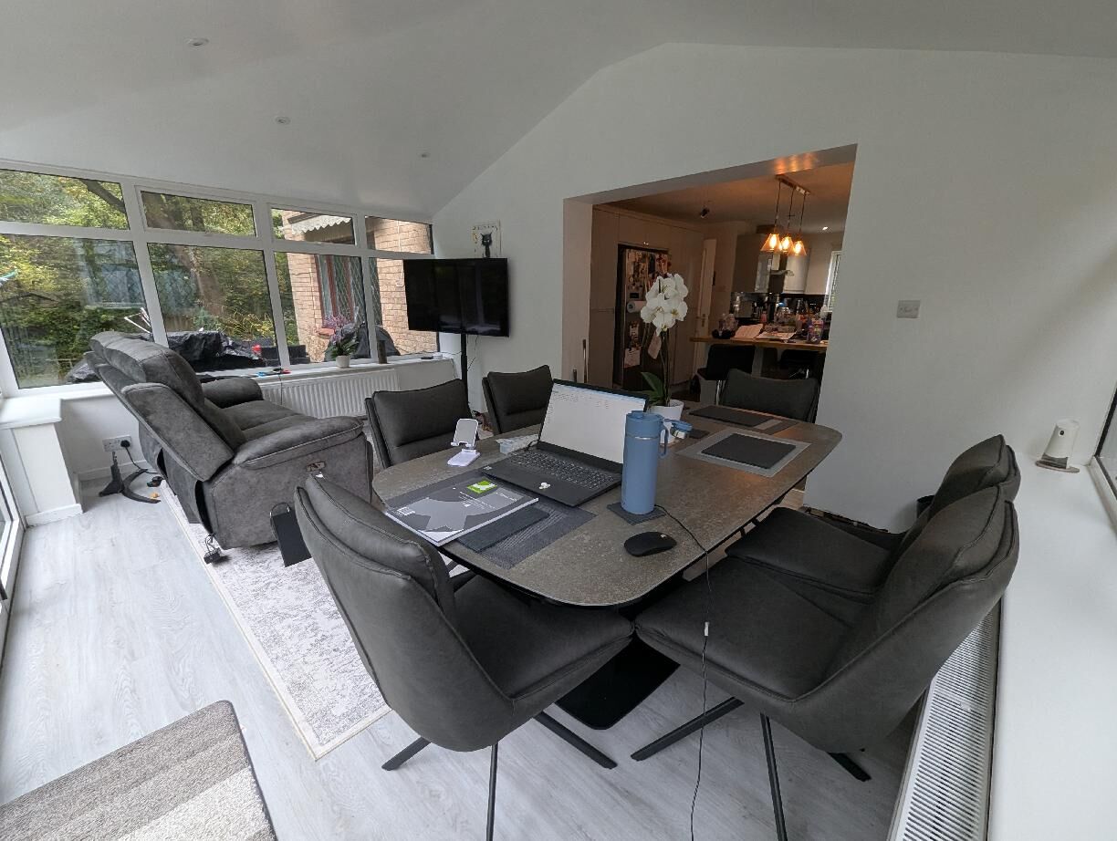

The conservatory rebuild was done over 4 days in late July, followed by re-flooring work and our own redecoration efforts, and it's fair to say that we are thrilled with the outcome. Having seen the extent to which the roof was insulated during construction it's easy to see where the improvement in ceiling heat loss will come from. The windows and new bi-fold door are still significantly glazed areas (just under 17m2 of glazing, as per the heat loss calculations) but the new double glazing will improve heat loss to some extent.
The big difference for us is that the room has immediately become one which the whole family, including the cat, now love to use and the conservatory area has gone from being an occasional room that we largely avoided in the extremes of winter and summer, to one which has become the de-facto dining area and a secondary TV room, so it's now a true full-time room. The only downside is that my Zwift indoor cycling setup has been banished from there into the garage, where motivation to go and use it in these temperatures is something of a challenge.
At the time of the installation we opted to leave the open area exposed by the removal of the doors and windows to see what it was like to live with, and we've subsequently concluded that it will stay that way. Similarly, we've kept the glazed areas uncovered to see how the room performed during winter without them, as the natural light that the room gets through them is a really appealing feature of the room, and we were reluctant to want to block it (the room itself can't be seen into by neighbours, so privacy isn't an issue). We're getting new blinds fitted in our living room this week, as part of a refurbishment of that room, and chances are we'll get the company we've chosen to quote for some form of roller blind solution for the conservatory.
From a heating perspective, it is easily reaching temperatures equivalent to the rest of the house, even in the current freezing outdoor temperatures. In the early morning it can be a degree lower than the adjacent kitchen area, but we're talking about it being 20°C when the kitchen is 21°C and it then catches up, presumably due to solar gain.
I thought it was worth giving a visual insight into this change as the updated conservatory area is likely still likely restricting what the achievable CoP from the heat pump will be, due to the significant glazed area within it. Installing blinds would no doubt improve that further, and it will be interesting to see if there's a noticeable change if and when that work takes place.
What's beyond doubt is that the room is now a much better proposition for a heat pump solution than it originally was. We never got to see what the heat pump would have done with the old one, as the two were only in place simultaneously for 4 weeks in June and July when no heating was required. The fact that we've been able to make such a significant change to that room has genuinely only come from considering the challenges presented by the heat pump quotation process. With hindsight, I'm extremely grateful to have been confronted with that dilemma, given how happy we are with the end result.
@sheriff-fatman looks very nice.
