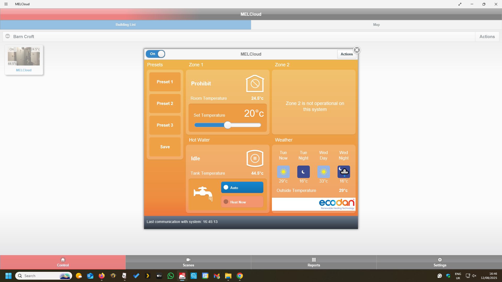

Firstly, the heating is switched off until 1st October, but MelCloud is showing "House Heating" as "Idle", whereas previous to the installation I think it stated "Stopped" or similar. Surely, it should only show "Idle" when in operating mode and having reached temperature?
(DHW is also showing "Idle" outside the timed operating period and I thought this also, previously showed "Stopped" only outside a timed period).

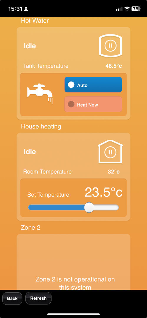

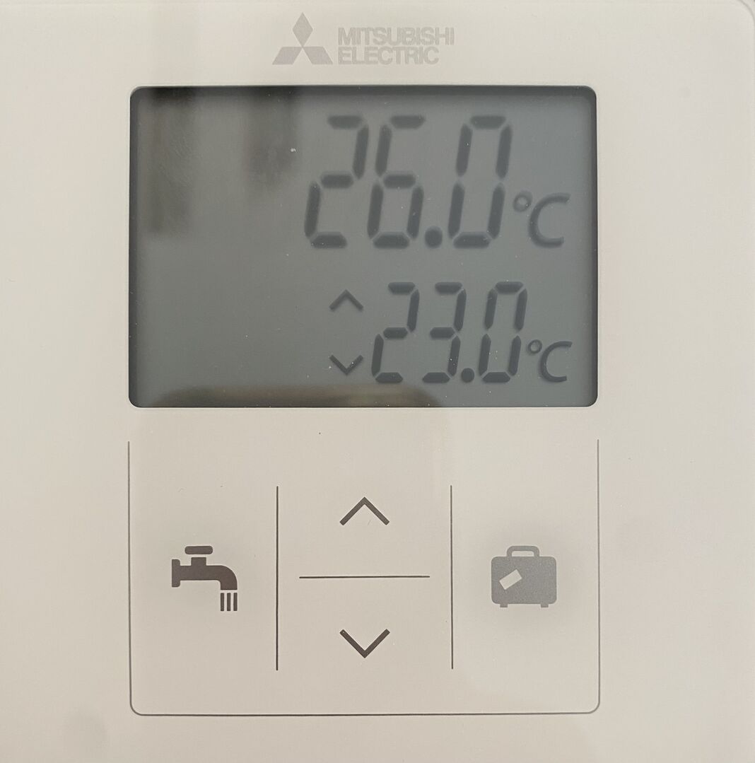

Secondly, the MelCloud "House heating" is currently showing "Room temperature" as 32C whereas the Wireless controller is showing a room temperature as 26C. I suspect the 32C temperature is being picked up from the thermocouple in the Hydrobox FTC6 which is located in an outside Pump Room. I seem to recall that I can change over the selected thermouple in the FTC6 menu, and would appreciate comments.

Yes, "Prohibit" was the word for when switched/ timed off.
So, apparently, my Melcloud is currently wrong for heating and possibly for DHW, but I am not sure if your DHW is currently switched on.

@davidalgarve My DHW is switched on.

It would seem that I have a problem (at least one!) in that both my heating and DHW are showing "Idle" when they are effectively timed off and the should be showing "Prohibit"

If they are 'off' because of a timed schedule, and this is their time to be 'off', it might be that it is actually in its 'idle' mode. I don't know that for sure, but in my post above, my CH is turned off in the main controller as opposed to a schedule, hence 'prohibit. The DHW is turned on but is showing 'idle' due to the temp still being above the reheat temp.
It will only show 'prohibit' if turned OFF. Not TIMED to be off. So far as I am aware.
I don't have schedules set. It's either on or off 24/7 or in Holiday Mode.

@morgan I am finding it hard to accept that the display should read "Idle" when either the heating or DHW is "OFF", because I am reasonably sure that it showed "Prohibit" for this condition before the wireless control was added. It would also mean that no difference is recognised between "Up to temperature" and "Switched off"
I am still hoping for advice on the second point i.e. the fact that MelCloud (32C) is not reading the temperature of the Wireless Controller in the lounge (26C) and as such it cannot control - see photos.
I feel certain that Melcloud is still displaying the Hydrobox temperature 32C, but cannot recall where this selection takes place in the menu.

Almost certainly, Melcloud is still seeing the Hydrobox temperature rather than the room temperature from the wireless controller.

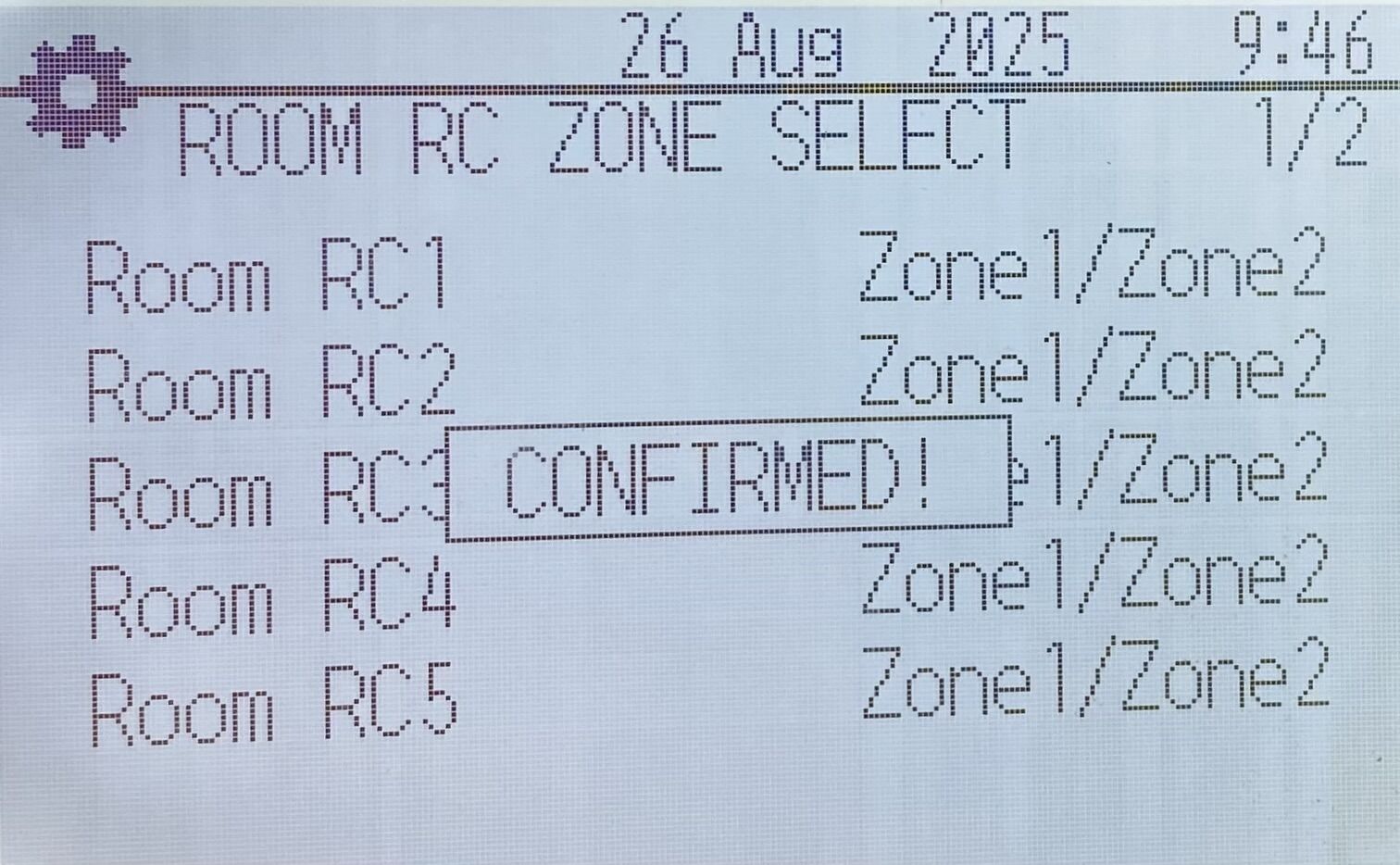

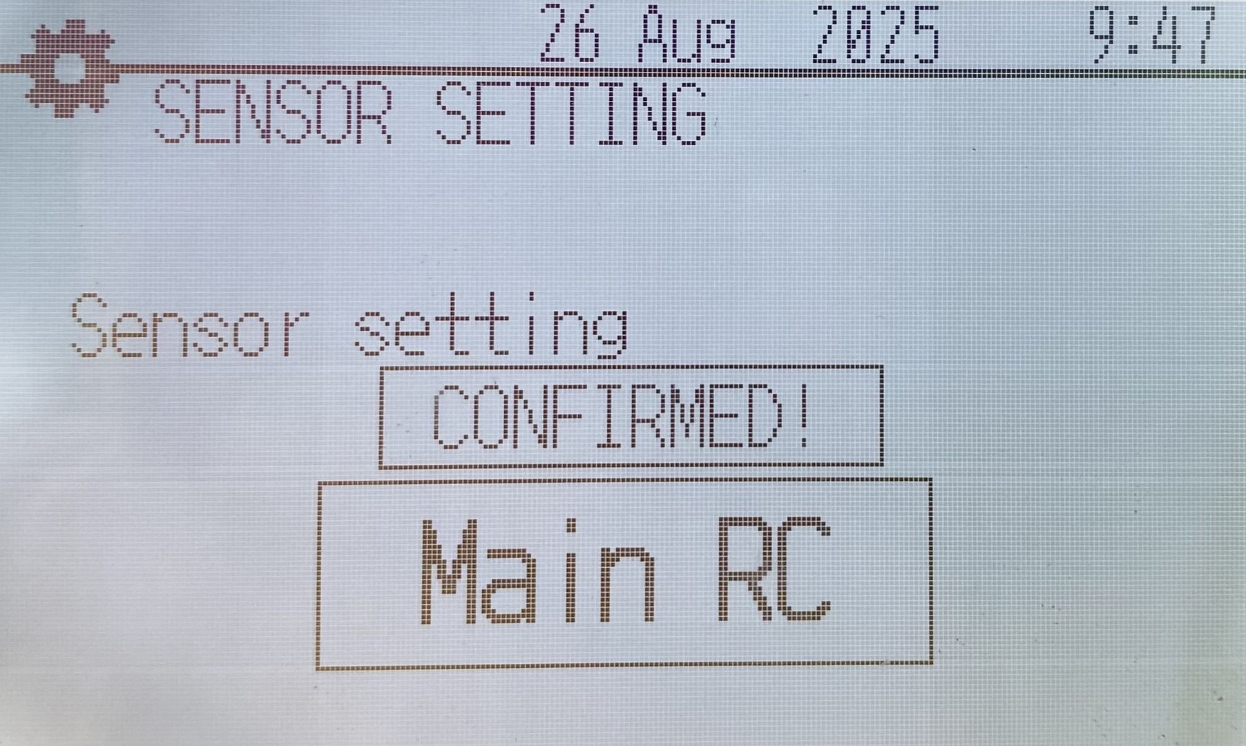

Hi David
We have an FTC7 but the settings seem to be similar to an FTC6. Our room sensor settings are:
Zone sensor selection sets zone 1 to RC1
Zone 1 programme sets programme 1 to RC1 from 00:00 (i.e. all day).
Looking at the FTC6 manual I'd guess Room RC zone select should be zone 1 and the Sensor setting for Zone 1 should be RC1 and a time of 00:00.
Hope that helps!

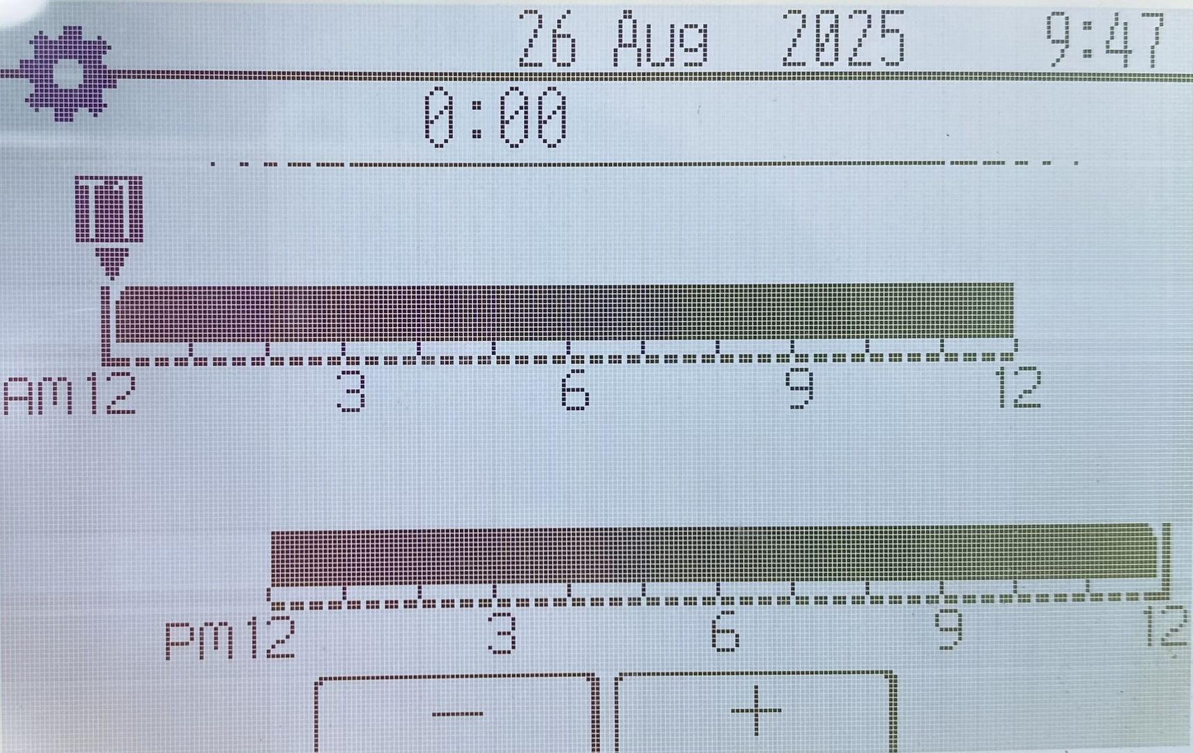

@robs Hi Rob,
I really appreciate your information, and this appears to me to be much clearer than that which is given in the manual under: "4 Customising your Settings for Your Home".
It seems that I was on the wrong track in suggesting TH1 and now recall that this is the thyrister in the FT6
However, just to be absolutely sure, before I attempt a second installation of the wireless remote, I am attaching photos of the 3 steps in making the settings. (Incidentally, I have left the "Time Zone" setting as was and this seems to be the same as yours, but I don't understand the significance of this in relation to sensors)
I would be grateful for your comments.
