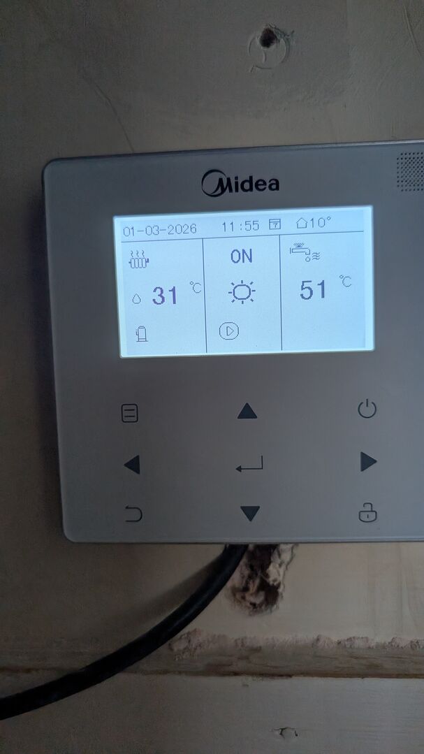

@cathoderay yes I kept touching the radiators every few mins as they got colder and colder during the DHW cycle. They then, almost instantly, became *hot* to touch once the 55 degree was reached and the system kicked over to space.
Another point of note today, at 11am the daily schedule to reheat hot water came on as planned. I think the tank temp was c.46 degrees after having had a bath and shower since the 55 reheat last night.
The scheduled DHW heating cycle only lasted about 20 mins this morning rather than the scheduled 2 hours and heated the tank to 51 degrees before switching back to space heating (despite the fact that the squiggly tap symbol was still visible. I'm imagining that this is due to it hitting 51 degrees (i.e. within the 5 degree reheat tolerance) so it's decided it can stop at 51 and switch back to space? Whereas, last night's cycle was a manual one to hit 55 so it will power through to 55 regardless?
So if I wanted to hit an actual 55 degrees each day rather than theoretical I would need to set the temp on the schedule to 60?
As expected it also did the same 'dump' of hot water into the rads at the point it switched over.

@painter26 welcome to the forum. However, I don't really get what you are trying to do with your DHW- why are you trying to heat the cylinder so high? A set point of 48, or certainly 50, would suffice. We have ours set at 48 and the outlet flow temp from our unit will reach 57 to get it there. Therefore to try and get it to 55 you're pushing the unit quite close to it's limits I'd imagine without using the backup heater.
With our wired midea control panel in weather comp mode the reading on the left will reflect the set curve point at that time.

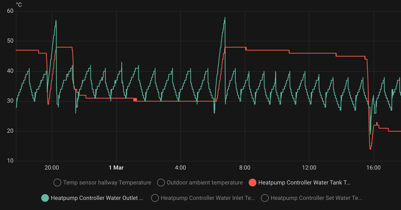

Parameters on the wired controller. Plate outlet and inlet ring a bell I think? The trouble is you'd have to continuously stand by the controller to see what is actually going on. This is why a number of us have ended up connecting various things to our ashps via the modbus connection to plot all of these values on graphs.
Here's mine- showing 2 DHW runs in the last 24hrs. The actual peak outlet temp run is quite short in duration so might be tricky to capture if manually trying to read the values at the right time. Red line is the tank temp and green is the outlet flow temp.

To be honest I'm not concerned for myself but as I've got family staying at the moment I wanted to be a bit more diligent at keeping a slightly more regular 55 temp. When you say pushing it to its limits - is this harmful to the external unit or just making it work at its hardest?
