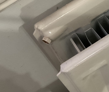

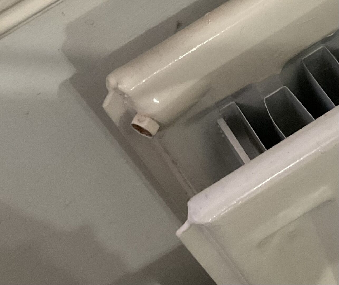

@agentgeorge this is a pic of the bleed valve that’s snapped. It should have a square bleed pin in the centre of that sort of nut insert.
The double panel radiators I’ve seen have a bleed screw on both panels.
Usually the nut around the bleed screw can undo allowing it to be replaced.
Id take the photo to City Plumbing and show them if they have spare parts for your style of radiator.
Alternative is to lock of the radiator valves for safety reasons, get a dremel and grind a groove in the bleed screw, then use an impact hammer with a slotted bit and hammer it free.
use WD40 on the bleed screw if it doesn’t budge and try again later. I’ve also used a blow torch on it to cause it to expand and crack the stuck thread.
If you can find a scrap radiator, you can obtain the replacement bleed screw, watch out for those trucks that go round collecting scrap metal, they’ve always got radiators on them; ask nicely and you get them to give you one
