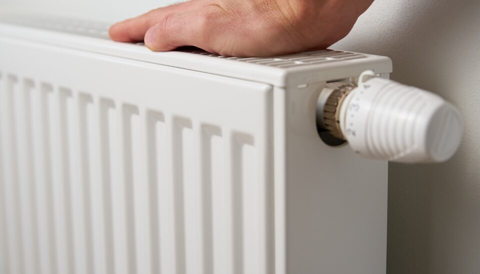

The lockshield valve acts as a ‘flow regulator,’ controlling the amount of heat supplied from the flow pipe into the radiator. It should not be confused with the Thermostatic Radiator Valve (TRV) fitted at the other end of the radiator. The TRV serves as a temperature limiter, reducing the flow of heat only in extreme circumstances, such as solar gain heating up a room. Otherwise, the TRV should not restrict the flow.
To begin setting up the valves, ensure all valves (both lockshield and TRVs) are fully open. Ideally, this task should be performed in colder weather to simplify the procedure. At this point, the heat pump can be turned on. Then, feel each radiator to determine which is warming up the most—make a note if necessary.
The radiators, especially if newly installed, should have been sized according to room size and calculated heat losses, along with the desired room temperature. Starting with the radiator that warmed up the most, gradually close the lockshield valves from room to room. Initially, you might close the valve by two full turns, with final adjustments usually being half a turn or less from the fully closed position. Continue adjusting each lockshield on the next warmest radiator.
Allow time for the radiator temperatures to settle after each round of adjustment. If some radiators remain warmer than others, they should be the first to be closed further. This process, requiring multiple steps of adjustment, aims to restrict flow minimally until each radiator sufficiently heats the room, allowing the rest of the heat to flow to other radiators. For instance, we prefer a warm bathroom and keep the lockshield valve fully open on this radiator, which is the first fed from the secondary pump circuit, keeping the room very cosy.
Once the radiators provide proportionate amounts of heat for the rooms, allow the system to settle for about a day. Then, you might find some lockshield valves need a bit more tweaking. Proper adjustment takes time; although installers may make initial adjustments, fine-tuning to your comfort level is crucial.
Consider using thermometers in rooms and a temperature probe on radiators to gauge progress. An infrared handheld thermometer can also assist in assessing radiator temperatures and the efficacy of your adjustments.
If using a room thermostat, ensure it’s correctly set so the radiator in that area warms the room to, but not above, the set temperature. Setting the thermostat slightly higher than desired can initially help avoid frustration. Once radiators are balanced, return to the heat pump controls for any final adjustments.
TRVs should now be set to start shutting at approximately two degrees above the required room temperature. Under normal circumstances, TRVs will not disrupt the heating system but will activate if the room experiences solar gain or another heat source.
