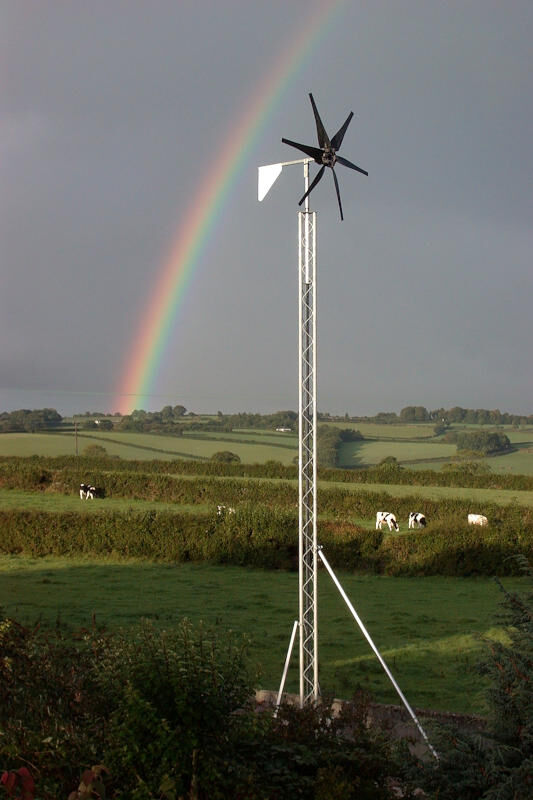

That’s right, you can have a wind turbine (subject to restrictions) as permitted development if you don’t have an ASHP and vice-versa. Installing either a wind turbine or an ASHP with the other already present, or both at once, requires that sound level calculations are done and planning permission is required. This had some rationale to it when the same was true of multiple ASHPs, first permitted development, second needed planning permission. That was changed for detached properties allowing two ASHP as permitted development, but not for a wind turbine and an ASHP.
Noise nuisance was my first thought. All wind-turbines require noise specifications to be provided to the LPA when submitting the application. That’s tricky because it’s not just the blades and generator which could be a source of noise, but the vibration of wire stays when wind-speed just happens to be at a certain velocity.
However I think the legislation is too wide in scope.
Imagine a rural farm on raised ground with an upslope from the direction of the prevailing wind. It’s a good location for a turbine. But that could be anything from a small domestic unit mounted on a 21-foot scaffold pole to a commercial turbine supplying to grid. The nearest neighbour could be well over a mile away.
These medium-sized turbines are widespread on farms across the West Country. They might generate up to 500kW.
I can’t see any overlap of constraints between this sort of turbine and an ASHP at the adjacent farmhouse!
Are the civil servants thinking of a domestic turbine within  a suburban garden?…
… in which case the definition of “curtilage" needs specifying.

I do have a wind turbine within the curtilage of my own home. But the farm buildings are ¼mile away in the valley.
