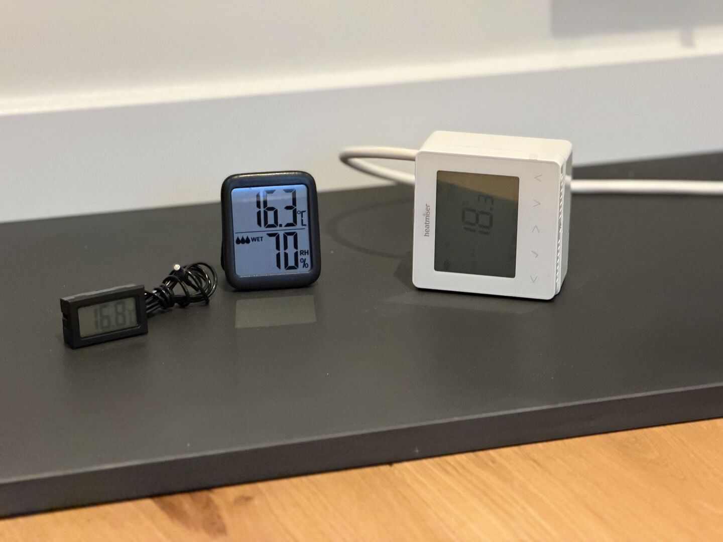

IMG 1413
I’ve purchased another type of temperature monitor as I wanted to reconfirm that the Heatmiser panels are showing temps that read too high.
Looking at:
  • probe 1: 16.8C
  • probe 2: 16.3c
  • Heatmiser (temp provided by installer to get ‘accurate’ temp of actual room): 18.3C
The Heatmiser panel is showing up to 2C higher than the other 2!
This to me says they need calibrating, and cannot be relied upon for determining that the system gets rooms to a temp of 21C.
The 2 probes I have bought have an accuracy if +/-1C, no idea how the Heatmiser can show 2C higher. Indicates to me as reading up suggests their power source gives them a higher temp.
The installer should have calibrated these…or dare I say has done so but favourably to them…

Heatmiser panels:
A big win in this was, the Grant engineer confirmed Heatmiser panels aren't that accurate - they need calibrating - in front of the installer (who said he was unaware that they COULD be calibrated…).
To illustrate it to the builder, when the Grant engineer was walking around with a thermal imaging camera, I asked him to point at the Heatmiser panel - it shows it generates heat.
So now these panels, once new ASHP is up and running, will be calibrated.
I have now got a Testo Wireless Thermometer with Air Probe (915i) that's rated +/- 0.2C.
I'll be confirming the panels are correct (the cheap Amazon probes btw aren't that far off!!!).
