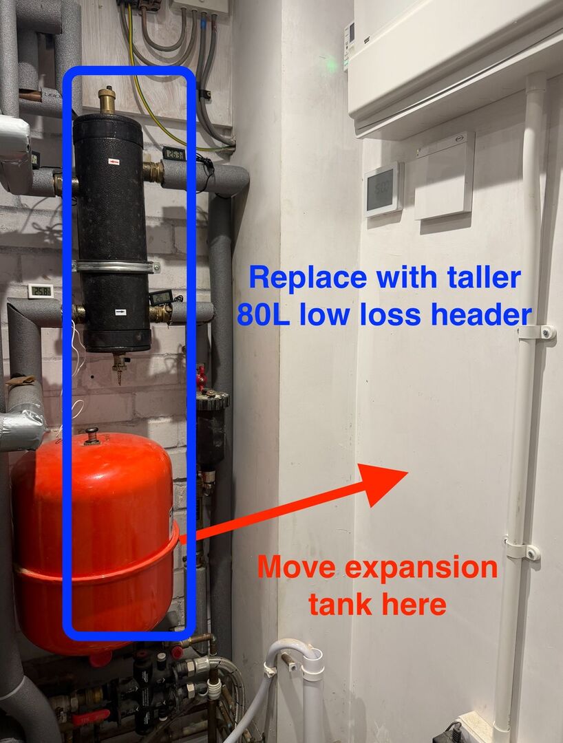

@jamespa - the Grant ASHP isn’t being replaced, the 13Kw will remain, apologies if I wasn’t clear. The heat specialist was experimenting with the current 13Kw in nightmode to see if it’s “oversized” currently not undersized if that makes sense. Currently in nightmode at 60% its normal power rate - it’s still heating rooms same as before (mind you its 8C coldest lately, no sub temps). The short cycling is still happening however.
It’s just the LLH header thats being replaced.
Attached is a photo explaining the works.
The heat specialist felt it’s physically too small and like to be mixing (hence him wanting to temp bypass it to prove to installer)
The day’s work is to also do some snags:
- replace a TRV - actual valve - not head,
- replace 2 clogged bleed valves in one of the Eskimos.
- fully drain system and add back glycol
I won’t be signing off the job until am happy the system performs at the designed flow temp of 40C with a weather curve.
Hope that makes sense. I’ve probably used incorrect terminology somewhere.
Posted by: @crimsonIt’s just the LLH header thats being replaced.
He is right. Better to eliminate it altogether. Is the Grant the R290 or the R32? The instructions for the R290 (which as it happens I was reading just yesterday) are very clear that buffer is not mandatory. Not sure about the R32.

To clarify heat specialist’s observations were (was writing this then saw your reply):
Due to space constraints Grant’s recommended low loss header / volumiser couldn't be used. LLH in place currently is very short. Upon running the system he could see temps at the 4 inlet/outlets on the LLH indicated mixing was occurring - meaning the 5 delta wasnt maintained and system cycled off.
Heat pump per calcs is to size however underfloor zone hits temps quickly, upstairs doesn’t call for 21C, which leaves the small front downstairs zone on and that has very small volume with the Eskimo rads. Cycling then occurs further.
Suggestion was to use an external Grant volumiser (30L capacity) - this wasn’t gone for due to a) they’re not convinced 30L will add enough and b) requires shifting the ASHP forward (additional works as its on a slab essentially - that would need to be extended)
Other suggestion was to also remove LLH altogether, plus house side pump, leaving just the Grant WSHP pumping water. wasn’t gone for as installers insist a LLH is required by Grant and there’s concern the Grant pump solely would cause further rad noise

Posted by: @crimsonSuggestion was to use an external Grant volumiser (30L capacity) - this wasn’t gone for due to a) they’re not convinced 30L will add enough and b) requires shifting the ASHP forward (additional works as its on a slab essentially - that would need to be extended)
Really dont, why would you want to put a volumiser outside where it gets cold
Posted by: @crimsonOther suggestion was to also remove LLH altogether, plus house side pump, leaving just the Grant WSHP pumping water.
Correct answer!
Posted by: @crimsonwasn’t gone for as installers insist a LLH is required by Grant and there’s concern the Grant pump solely would cause further rad noise
First part - check if its the R290 or R32. ask for proof. Second part semi BS. Yes it could do this in principle, but only because its pushing the amount of water through the system that is needed to transfer the heat! If the system cant take it then something needs to be done with the system!
Conclusion: Heat specialist is almost entirely correct, installer is out of his depth and a BS merchant who just wants to fob you off with a quick fix which, in reality, he doesnt know will work because (a) he hasnt done enough work on diagnosing the problem and (b) he probably doesn't really understand it anyway
Thanks @JamesPa, I think the external volumiser suggestion - supposed to be insulated - was on assumption no space inside but yesterday’s visit it was drawn the conclusion that moving the expansion tank meant a buffer tank could replace the LLH without affect access. I think the whole Grant specify a LLH excuse statement has caused this impasse as it were (in convos the heat specialist’s was keen to just remove it)

A quick google states the Grant Aerona3 requires a low loss header as a mechanical break as part of Grant’s install package - I suspect they’re using the install package and not opting to not have the LLH.
Posted by: @crimsonA quick google states the Grant Aerona3 requires a low loss header as a mechanical break as part of Grant’s install package - I suspect they’re using the install package and not opting to not have the LLH.
R290 has an explicit installer setting for 'no buffer'. It couldn't be clearer!
Not sure then, I’ve been reading the manual and it does state it needs a volumiser, and even suggests options for low volume systems (why they didn’t think to go with that I don’t know). However having a volumiser is a prerequisite, it doesn’t state that it needs to be on the flow UNLESS it has an element to supplement heating (which this wouldn’t).
References to a Low Loss Header are only included when its states you don’t need a volumiser if you use a combined volumiser and low loss header.
I’ll try to prompt the installers to think upon that as thats effectively what the specialist was suggesting, use the buffer tank/LLH as a volumiser on the return as per your notes and the specialists.
Just don’t get why they cant get passed having this LLH, when clearly when first installed wrong way round caused issues and even after a hugely significant emitter uplift (upstairs went from K1-K2 along with the Eskimo increases), we see mixing indicated on the probes and temps not showing huge increase. Just obvious something other than the rads is causing this.
Overall it seems they’ve gone - client picked eskimo, they only want Stelrad, so point fingers at Eskimo (even though they approved them). They should have checked system volume with the install.
I’m at point now of reaching out to Grant directly for them to confirm if its required on the flow, or if it can just be put on the return.
Posted by: @crimsonsure then, I’ve been reading the manual and it does state it needs a volumiser, and even suggests options for low volume systems (why they didn’t think to go with that I don’t know). However having a volumiser is a prerequisite, it doesn’t state that it needs to be on the flow UNLESS it has an element to supplement heating
Volumiser totally different to buffer or llh. Volumiser 2 ports, buffer/llh 4, volumiser doesn't cause system distortion, doesn't penalise COP, buffer/llh does. Either solves defrost issues and mitigates short cycling. I have no problem with fitting a volumiser!
Best to put volumiser on flow but it's ok on return, something of a discussion on this earlier in the year with a difference of opinions at start but convergence at the end but also general agreement it doesn't matter that much in the absence of an integral heating element.
