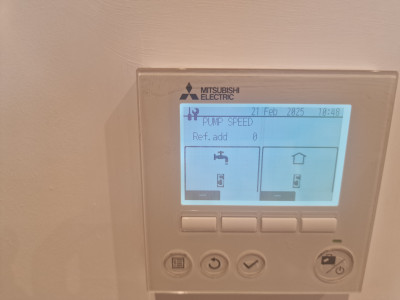

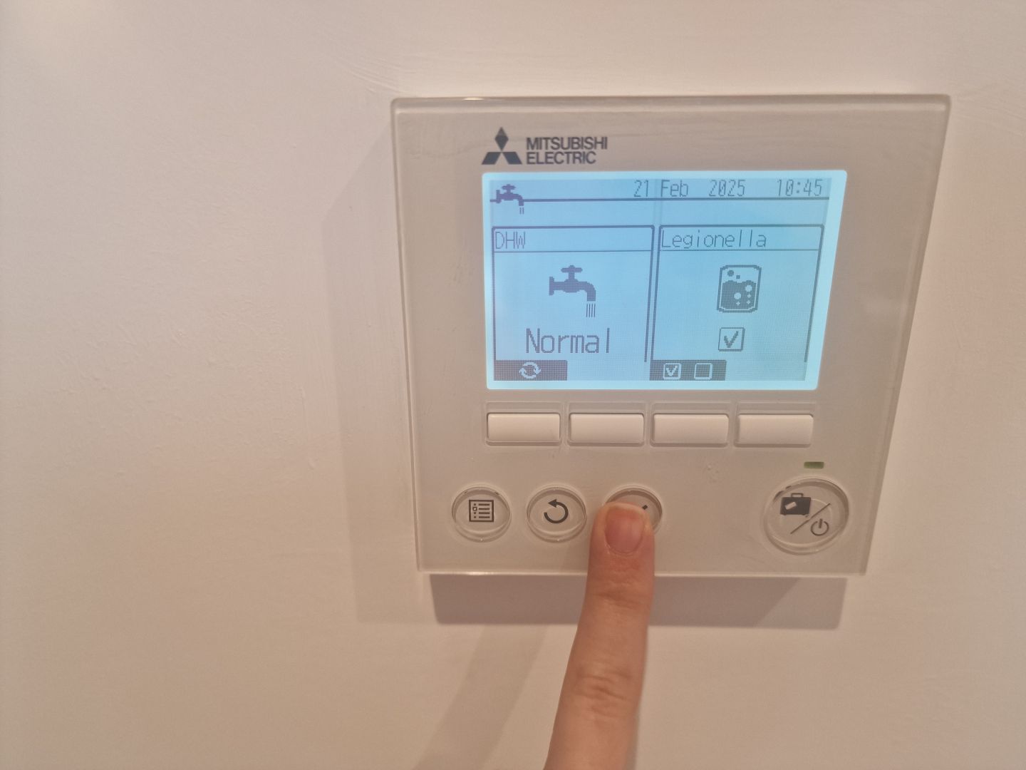

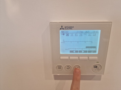

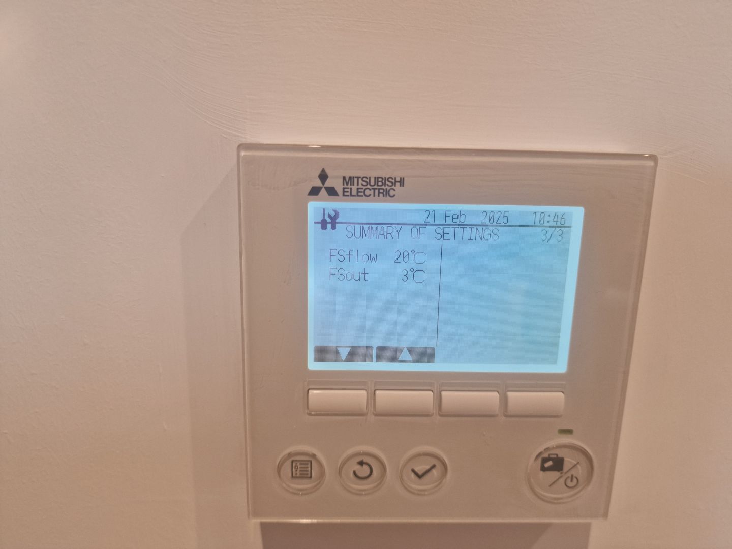

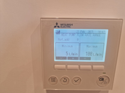

I am attaching pictures requested, plus the current settings ( untouched by my magic fingers) on the main board that lives in the utility room. I know for sure that these can be optimised.
My issue is that i have a cold house, water that is randomly cold and hot and paying £20per day for electricity. Like I said, downstairs achieves 21 degrees , but upstairs nothing goes above 20.
Also , I hate these stats. constantly having to adjust them as some go to 12 degrees some to 19 . I do not undestand why they were put in ...Nevertheless, i have 4 of them to tell.me temperature and what i can t achieve.
trying to attach some pictures. hopefuly it works . if not let me know....they are all in something called my media...

One of the pictures suggesting DHW is programmed to heat from 7.30-12 in the evening - really?  An hour and a half twice per day (not at prime heating time) might be better.

I have the same heat pump and all of those setting look spot on, you are running pure weather compensation with a reasonable curve, the house shouldn't be cold, so the issue is in the emitter side of things rather than the heat pump.
If the heat pump was running flat out 24 hours a day and it was freezing outside it may use 100KWh in a day.  How much did you use yesterday its much milder, if its a similar amount I would suspect you need to find the immersion that's the logical culprit.
In the running information menu when the heat pump is heating put in code 540 and report the value that is the flow rate of the heat pump needs to be 15L/min with your pump set at 5 I suspect its much higher so can be dialed back but if its very low that won't help heating.
The hot water settings look fine as well other than what James said move the schedule to overnight when you don't need to heat as much.
Unless you are having very high hot water usage i.e. multiple baths a day you should only need to heat it once.  We heat 12-2am to 47C that's enough for 2 showers, washing up and a full bath without reheating at any time during the day.
