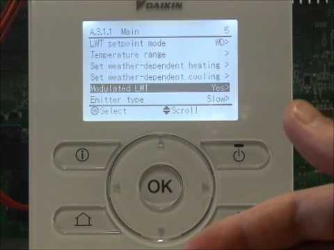

Daikin user manual is here and it explains how to program DHW. Check its actually programmed before you pay anyone, there may well be nothing wrong. If it is programmed then check the diverter valve as suggested above.
If engineer can check the ferroli and you can find out if the Daikin is actually programmed to do DHW then you may be good to go with a fairly workable set up.

the original installer who also carried out the ‘fatal’ annual inspection has acknowledged they have created an issue (probably turning off the DHW settings) and will walk me through the control box / system on phone hopefully tomorrow. I am also due another annual review to keep the warranty live till 2026 - they said they would provide ‘an extra hour’ of face to face advice after that inspection. (Different engineer this time).
