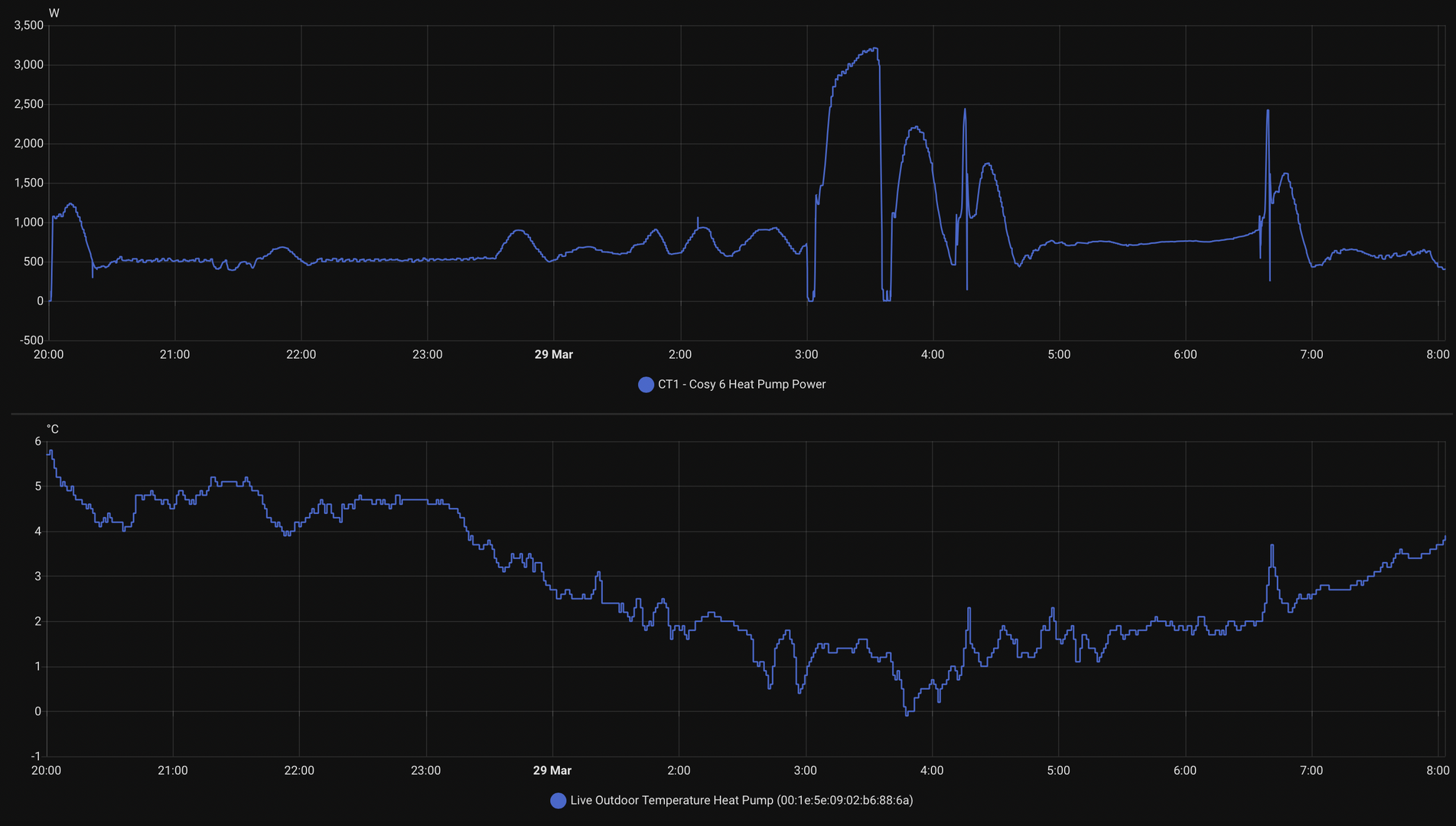

Went down to 0 degrees last night. Still oscillates a bit but not as bad as before.

@editor I can't tell much on the sound side outside as I run mine in a different way to most (house set point 30 degrees, overall house temp managed by flow temp settings) but from the heat output data it seems the hot water cycle peaks at 6kW still but ramps down whilst running to 5kW. When I ran a test with fixed flow for central heating it was pinned at 5kW output. It will be hard to test actual sound without a decibel meter.

Our Cosy 9 has been in hush mode for three days. So far the reduced 'power' isn't impacting negatively though the aot has not dropped too far so hard to tell.
It does seem to be more consistently running at low revs, possibly for longer, however both kW in and cop are marginally down. As always it's difficult to say after just a few days.
Overall I'd say thumbs up.

Meant to say "It does seem to be more consistently running at low revs, possibly for longer, however kW in are down whilst COP is marginally up.
