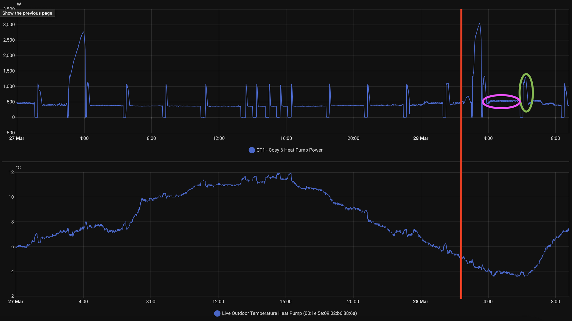

The new behavior seems to kick in after 5 degrees. You can see below where the red line is when the outdoor temp is below 5. The peak just after is the hot water. The green circle is a new behavior as well where it seems to boost to get the flow temp up after a restart. The pink is also new, normally it would be fluctuating like crazy here but it is now pretty stable.
I will have to see how it goes when it gets even colder but hopefully this is a more stable control loop.

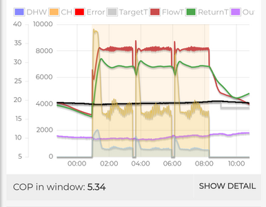

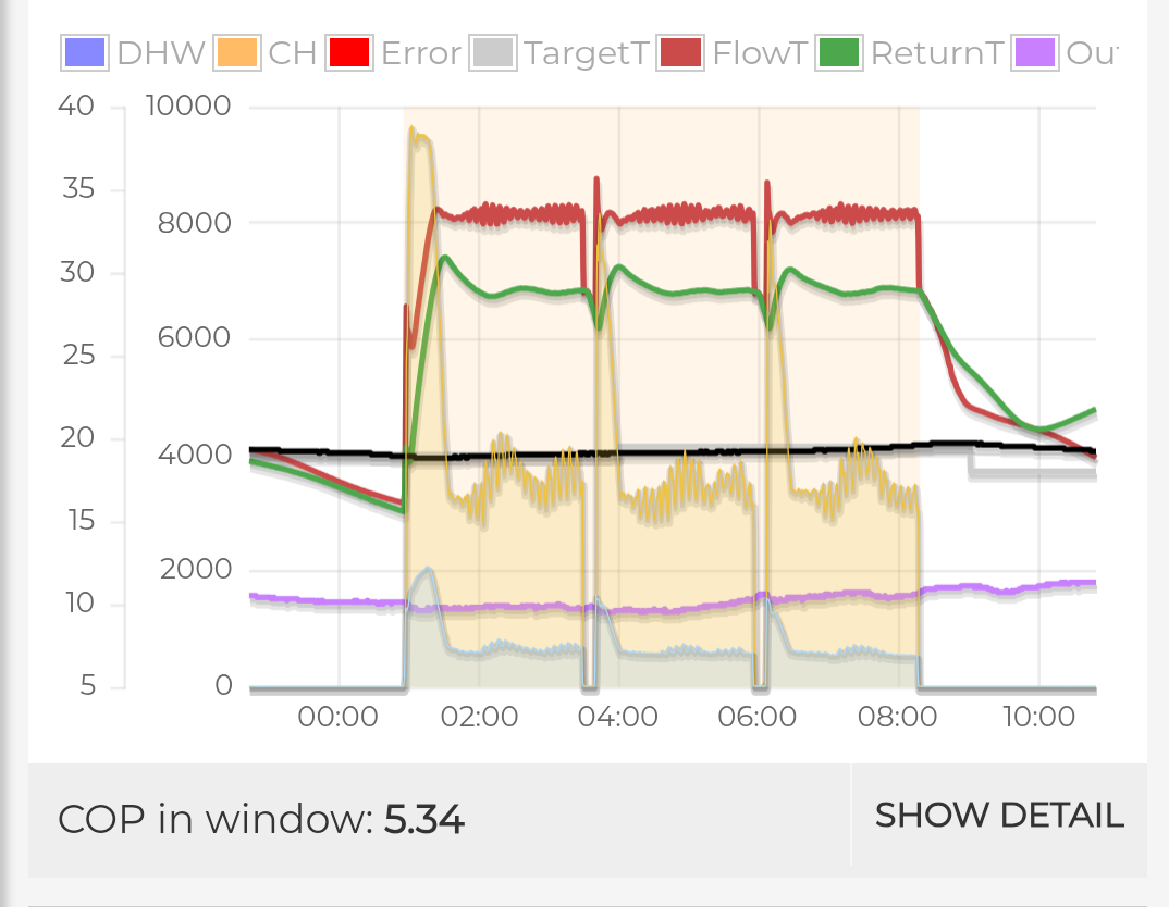

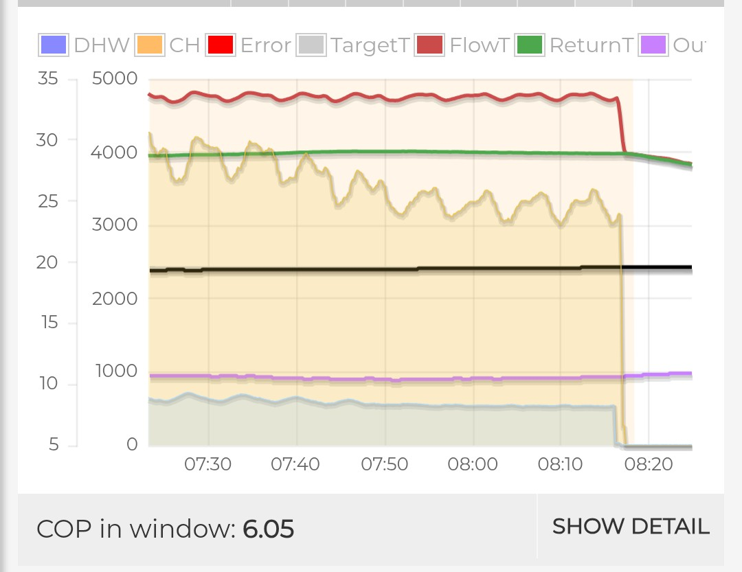

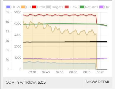

(@swwils)
Posts: 97
It ramps differently now and then doesn't ramp as hard afterwards, there is also much deeper modulation of the heat output. So basically it gets into steady state better and stays in steady state.

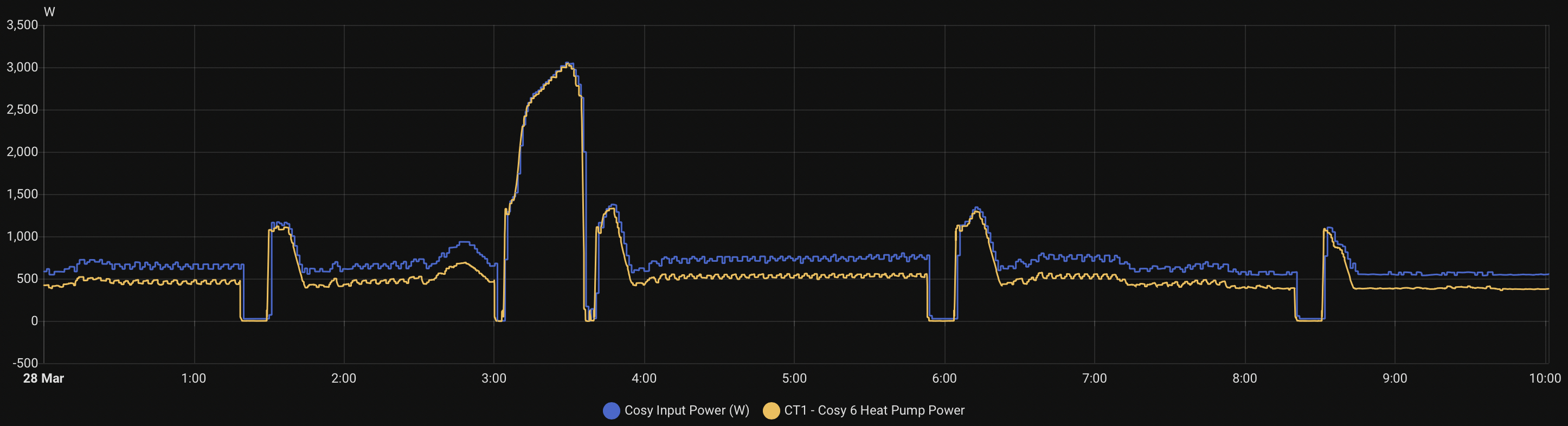

@swwils Next thing they need to fix is correctly measuring power. What card are you using for Home Assistant for these out of interest?
(@swwils)
Posts: 97
@harrisonc it measures electric exactly and heat within 8% of my MID meter so that's pretty damn good.
It's not HA
(@harrisonc)
Joined: 11 months ago
Posts: 20
@swwils are you on Cosy 9, as the Cosy 6 definitely doesn't when it modulates down. Does your Cosy heat output under or over-report?
ah should have known it was OEM based on the black line.
