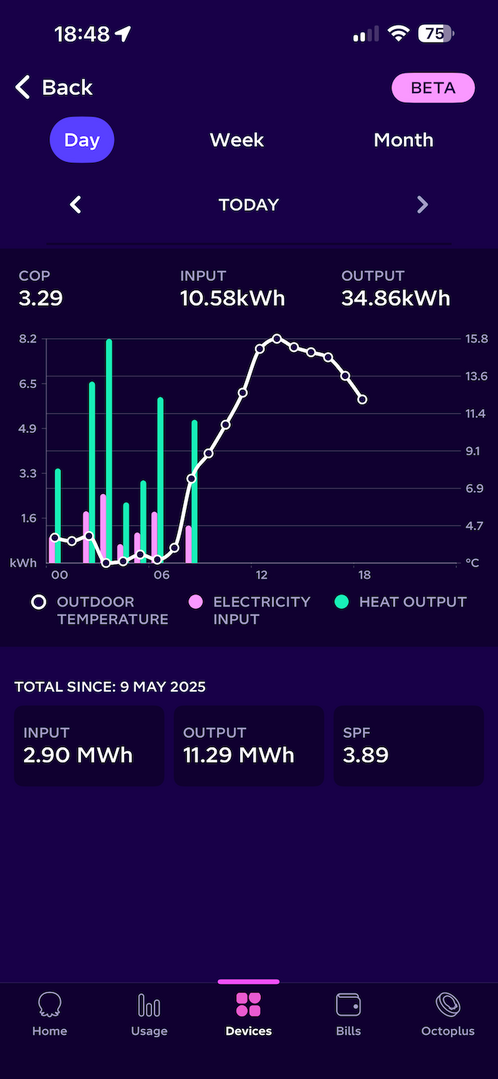

IMG 2523
With the current outside temperatures I'm finding that I don't need heating on at all during the daylight hours.  The schedule is set at 22c from 18:00 to 09:00 and 20c 09:00 to 18:00.  What I'm finding is that the heating will probably come on around 23:00 and be on/off during the night - this morning, the last heat run was sometime between 08:00 and 09:00 (closer to 08:00 but I can only break down runs by hourly increments); hot water is created 02:30 to 03:30.  Solar gain is raising internal temps of the house to around 22.5c downstairs and 23.5c upstairs and it only drops under 22c around 23:00!
Strange state of affairs though, with the east side of the house above 22c from some time after sunrise but the west side of the house fluctuating around 21.8 - 22.3c (heating on so keeping it at that range), which of course adds further heat to the east side, until late morning when solar gain starts to take effect.  I made the 20c daytime setback today because even with the room at 21.5c or so it still felt comfortable because of the blue skies outside (21.5c in winter with rain and cloud felt cold...) but because it was still calling for heat it started to feel too warm.
Clearly, this is a good cost saving and I can't argue with that.  With the heating only required over night during colder hours though, the COP is quite low - to be fair, it's ok given the OAT but on other days with larger OAT swings the warmer periods would drag the COP up which isn't happening now.  I've attached an image of usage today to show what I mean - note that the SPF = SCOP = quite reasonable and is currently "flicking" between 3.89 and 3.90, with a full year's calculation only available on 9th May.
The system runs thermostatically, as I've already reported, and I haven't bothered previously with setback temperatures.  I may give that a go now, perhaps setting overnight to 20c with a raise back to 22c for 05:30.
I'm guessing that this time of year involves more fiddling with settings as the OAT temps fluctuate.  If we hit a cool spell again, the schedule will have to revert back.

@andrewj
Same here.  I have a slight setback between 21:00 and 4:00 and have found that during this warm spell the Cosy has been kicking in at around 2:00 until around 9:00, then nothing until a DHW blast in mid-afternoon.
Despite this the COP is only down a little (still above the SPF though) and, remarkably, the SPF is sitting at 3.62, almost exactly where it was forecast to be after 12 months (installed 25 March last year).
All things considered I am pretty pleased with overall performance and I expect that the SPF will improve in year 2 now that I think I know how to get something approaching the best from it.
