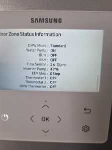

Here you go
20221201 114543
20221201 114549
20221201 114631
(@craig1980)
Posts: 146
Measurements in brackets are on 35 flow temp setting.
20221201 115159
(@craig1980)
Posts: 146
Room temp is slowly climbing. Up to 19 now.

Thanks Craig, now lower the LWT setting to 30C and see what happens to how the system operates.

That is to be expected during the testing. What changes have you made to the Field Setting Values?
(@craig1980)
Posts: 146
@derek-m none. I've just followed what it said in the video link that I sent then set to 35 now set to 30 and timing shut downs as it has turned on and off.
