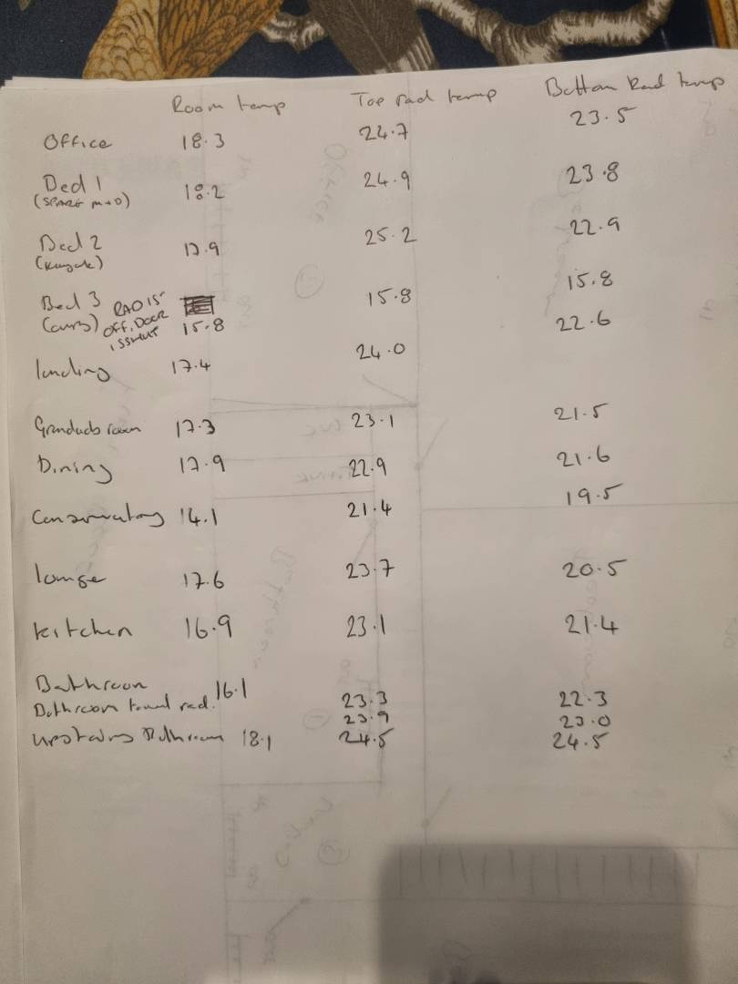

But at the beginning of the 8 min cycle they are both within 0.5 degree of each other at 22
Outside unit heat pump fans run for around 5 mins then it's quiet until 8 mins and 20 seconds then it starts again.Â
I will have a look at the data and get back to you tomorrow.
In the meantime, with the system running, measure the temperature in the central section of each radiator at both the top and the bottom, along with the relevant room temperature.
