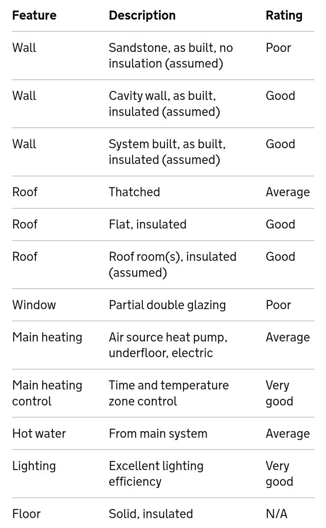

I've been through an extended process on my EPC update.
Mine was done in 2020 pre ashp & solar/batteries
Updated recently to take into account changes. But i had not realised the criteria changes meant i had minuses as well as pluses
Latest criteria also mean glazing is more accurately measured for size and other detail. I have a lot of glazing - some single & some double
I was hugely disappointed that the heat pump was rated average & Hot water rated average. Both benefit from COP.
Anyway
Previous epc was D 67
Now D 62
In 2011 it was E 44
In 2015 after the modern extension it was D 55
At the end of day I've given up fighting further! It's all a nonsense.
With the improvements I've made i think the logical EPC would be mid C
Half house is modern build & insulation
Half is old, listed
Ashp, solar, batteries
Screenshot 20260109 201333 Samsung Internet

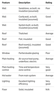

@tim441 I share your frustration with the EPC ratings. Attached is an extract from my new EPC which was done this week. You'll see that the Main Heating has the same description as yours but that it is rated Good, rather than Average. The old EPC (done in 20127) rated exactly the same setup as Poor. Nothing about my property has changed so it must be the way the algorithm treats heat pumps.
EPC ratings lack transprency in the way the scores are reached and also appear to lack consistency between the same features in different properties. Merely by getting a new EPC I achieved an overall rating increase of 12 points. The only difference to the property between the old and new EPCs was installation of a Smart meter.
