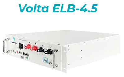

The sheer bulk of an Na-ion cell is also significant.
We're used to see a typical 4.5kWh or 5kWh battery in a rack-mounted enclosure which can be assembled by a two person team.
That restricts the lifting weight to 25Kg each (H&S rules)
But the 4.5kWh Na battery from Eleven weighs a whopping 54.5Kg.
It's 555mm deep and 150mm high.
For comparison, a 5kWh LFP battery from Pylontech would fit in the same 19"-rack frame, but would be 450mm deep and weigh 40Kg.
Commercial BESS containers seem to be using the same sort of LFP rack-mounted  units as the domestic market.
Switching to Na-cells would necessitate a larger overall container which would be heavier to transport to site.
The odds are still in favour of LFP technology.

Posted by: @transparent
I was told when I met the team from Midsummer Energy last year at InstallerSHOW that the Eleven sodium ion batteries were about 30% heavier than lithium ion equivalents. These seems to be significantly more though.
Still intrigued by the batteries though. Might have to step up my exercise regime and start building bicep strength.
