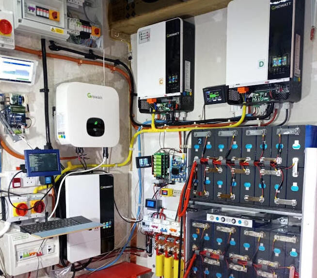

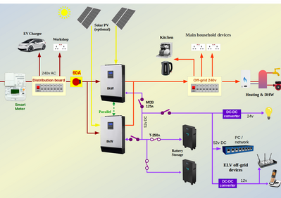

I have a plant room where I breed off-grid inverters.
Their 240v output is not synchronised to grid frequency.
They have their own integral 50Hz frequency generator.
The only reason my DNO knows of these is because National Grid's Area Manager is sufficiently interested that she came and had a look...
... over a very long cup of tea 😎
PlantRoomOthumb

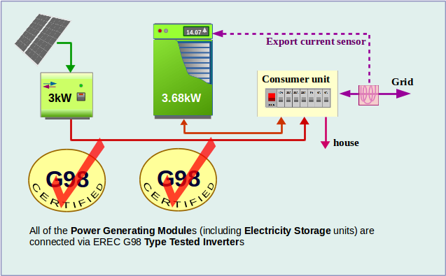

The EREC rules for grid connection apply only if the inverters have the potential to export to the grid.
those inverters have G98 certification.

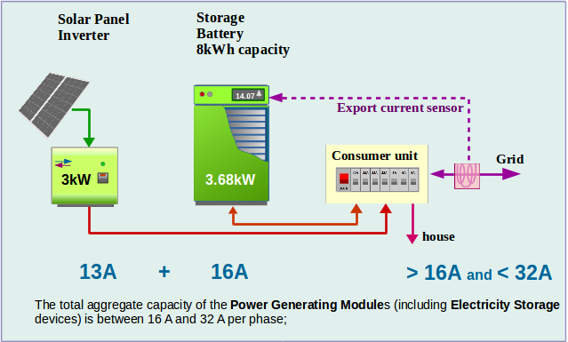

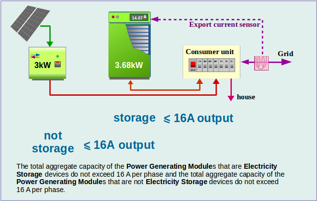

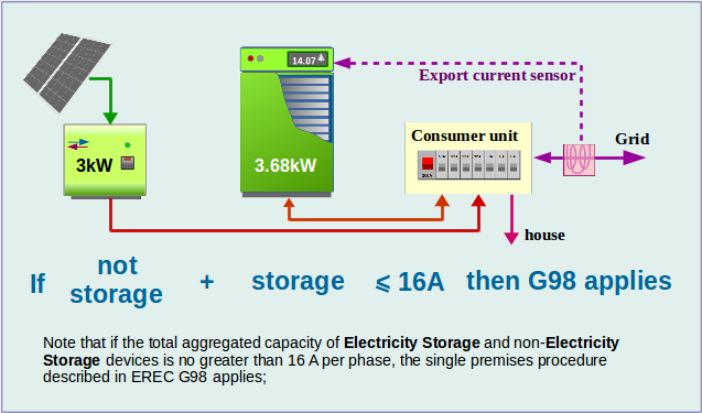

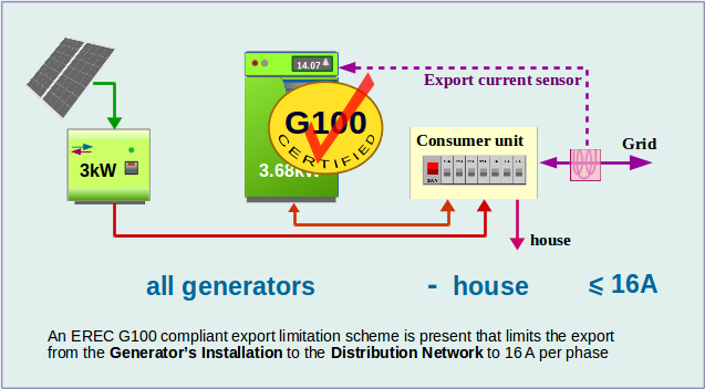

Thus, if you have an inverter capable of outputting 240v AC in synchronisation with the 50Hz grid frequency, then you do need consent, even if you use all of that power in-house.
G99 applies if you have more than one such device installed.
Typically that would be a solar inverter and a storage battery.
The EREC G99 language can be difficult to follow,
so I've re-interpreted it into a series of five diagrams:
G99 rules1
G99 rules2
G99 rules3
G99 rules4
G99 rules5
Does that start to answer the point about what the DNO licensing is about?
It can get messy if you want to install solar inverters with their own inbuilt export limitation system...
and storage batteries which have a separate export limitation mechanism.
But it's still possible to achieve in 99% of cases.

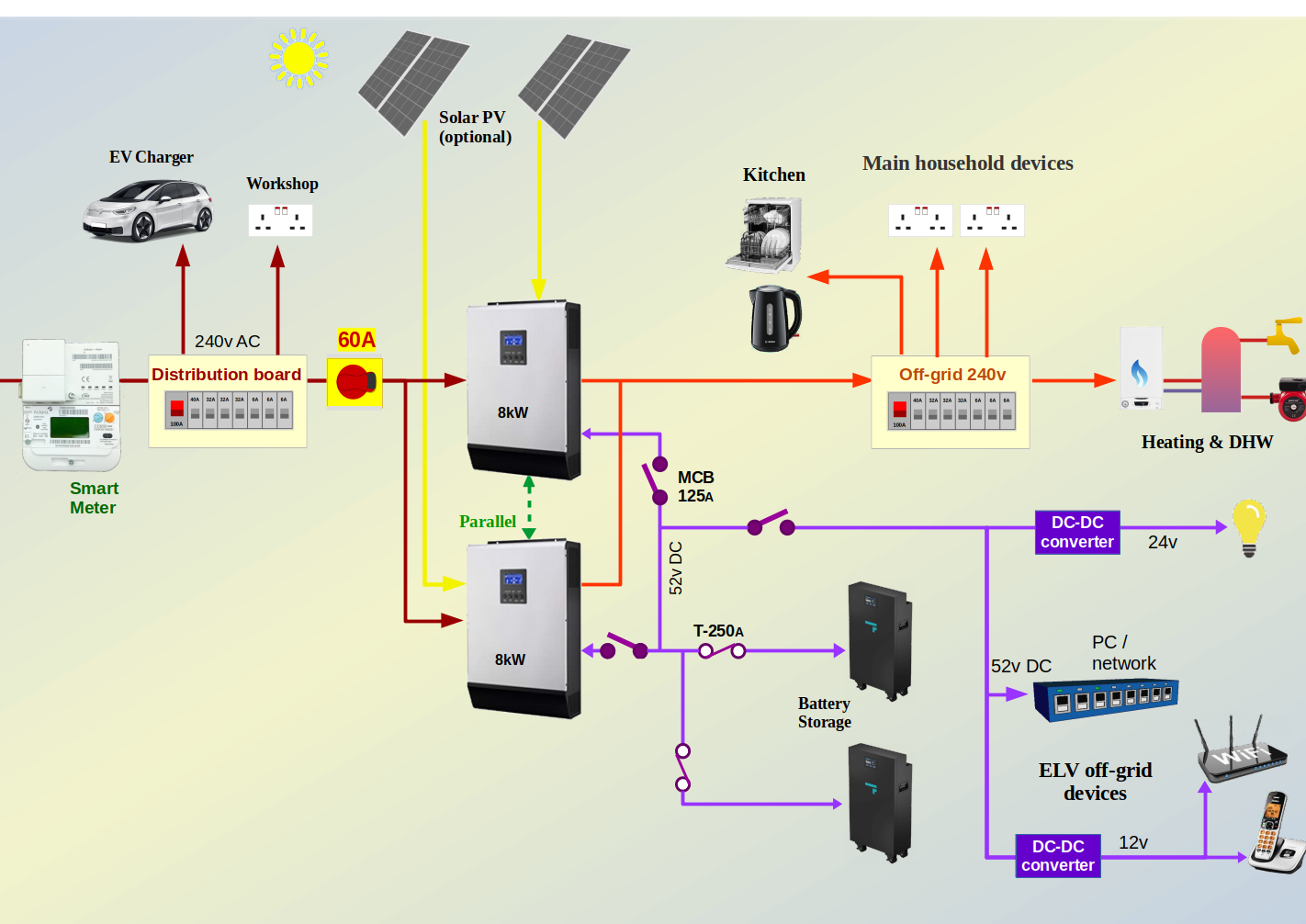

My own home has a lot less mains frequency (50Hz and its harmonics) than those of most other readers here.
That's because I have DC distribution systems for lighting, computer equipment and CCTV.
Ie those devices are supplied from the DC of the LiFePO4 batteries you can see in my photo.
Off Grid battery6spG2
