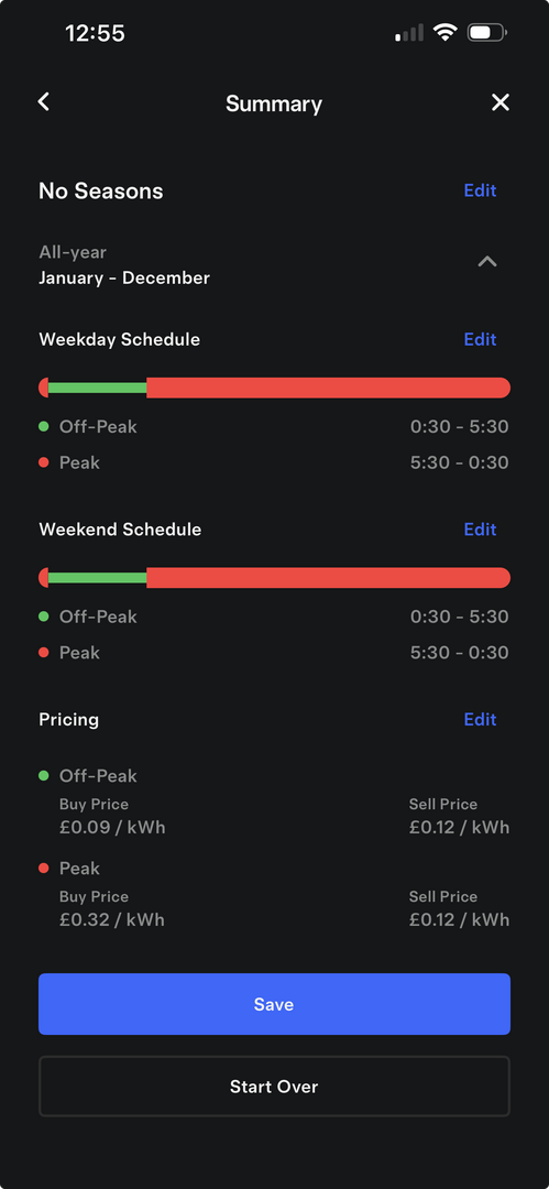

I have now found out how to get to the settings for this.  I have attached what I have set up.  Does it look right for my simple tariff (0:30 to 5:30 cheap rate, all other times expensive, solar export 12p).
Screenshot 2026 08 01 at 12.55.21

@trebor12345 Yes, but no! You want to exaggerate the differential in price.
Try it if you like, but my guess is it won’t do what you want it to. Try it this evening, if it doesn’t fully work get back to us for some suggested changes (it’s not a precise science as none of us understand the actual algorithm it uses)

@trebor12345 Are you paying 9 pence for the ‘EV hours’? At least you have a differential there but as suggested earlier, you can persuade the Powerwall to do your bidding to ensure it responds favourably; you might set the off peak to be perhaps 2 pence buy price and the peak buy price £1.00 which will reduce any shadow of doubt when you do and don’t want to use the grid. Rewards (I hope!) Toodles.

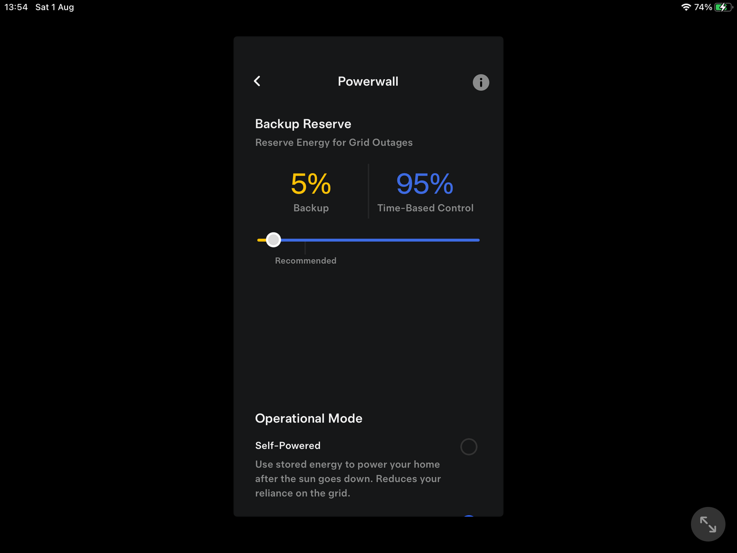

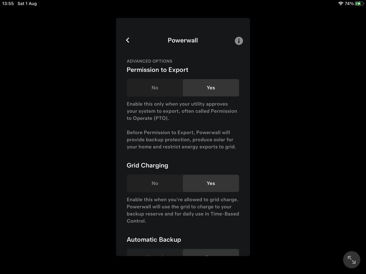

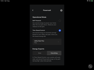

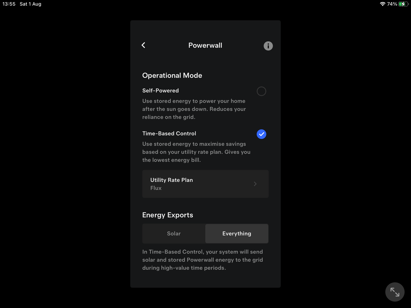

@trebor12345
make sure your powerwall settings are as follows.
IMG 0306
IMG 0305
IMG 0304
Yes I have those settings.

I have no EV, but the 9p is for cheap overnight rate.
How does the Tesla app respond to these settings verses the settings that are used by Octopus? Is it just to "fig" the software.  A bit beyond my comprehension at the moment.
