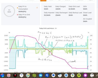

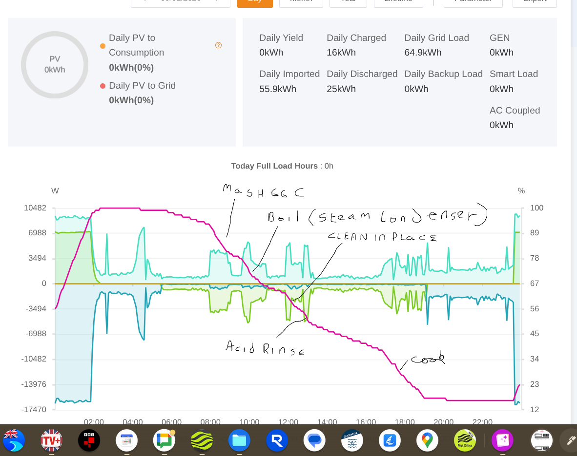

This was the graph from the brew day which used up all the battery!
Brew day01 09.01.2026
