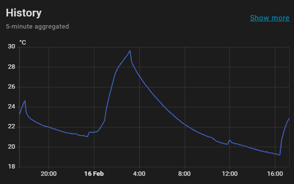

I also double checked the maximum charge rates possible with the cells in my battery (they also vary with temperature) and manually adjusted them.
For some odd reason the temperature readings are different via the BMS and via Solis modbus, the ones below are via Seplos bluetooth.
