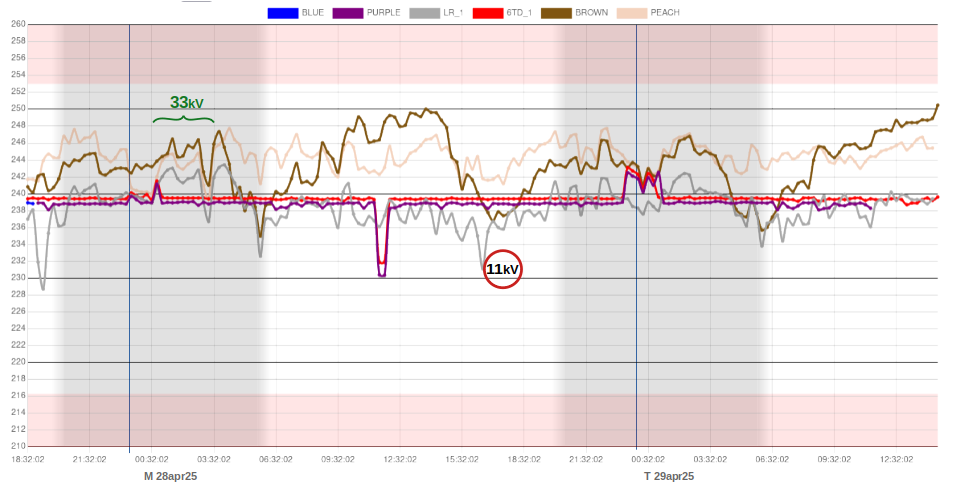

OK... so that requires a bit of grid monitoring, but not as much as you might suppose.
If I have LV monitors on several different 11kV (rural) feeds from a Primary Substation, I can detect which fluctuations are constrained to each feed,
and which are due to effects at the area-wide 33kV level:
Ignore the red & purple traces - they're being manually controlled.
The voltage rises/falls between 00:30 and 03:30 are area-wide because they affect Brown, Grey and Peach locations equally.
In contrast, the sudden dip detected at 16:15 by the grey monitor is peculiar to that Feed.
