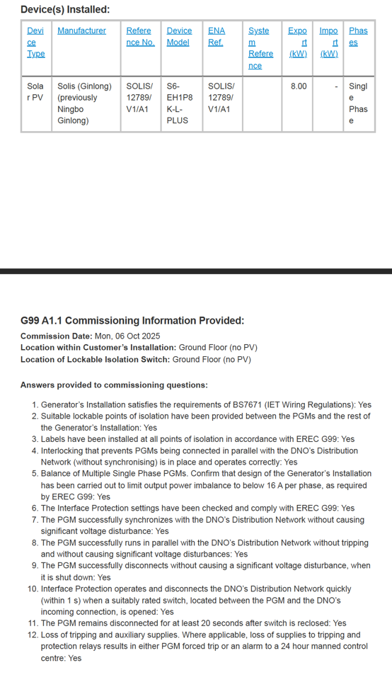

Quick update, I submitted the G99 to the DNO. Curious to find out how long it may take to bust the "need an MCS installer" myth on a home battery setup.
Posted by: @old_scientistIs your installer MCS certified? If so, they should register the install and provide the paperwork for you.
So I can now confirm that no MCS qualified person ever touched this! I used electricians and if anything, the installation was overspec´ed. I had it all inspected after labelling, etc, no changes were recommended.
It seems it is not just 5kW. Instead it should be 8kW approved for export. I await the MPAN and will be sending it to Octopus shortly.
The G99 was accepted by the DNO, the rest is history! Over 2/3 of the £3200 estimate that MCS chap gave me (to run two cables and sign some paperwork) is ready for the next project! PV leveraging the Solis hybrid inverter?
From what @transparent mentioned, it is not common to have 8kW export approved with a single phase service.

Luckily, the DNO is the competent organisation and they already approved it. Perhaps it is since there are few PV installations in my neighbourhood.
If they eventually decide to change my supply to triple phase, it may be less than 10 meters to be dug up...

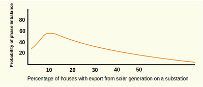

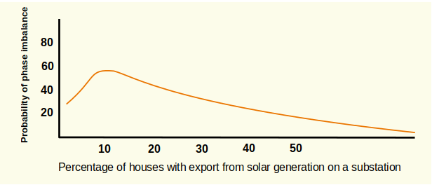

I don't think you've appreciated the nature of phase imbalance.

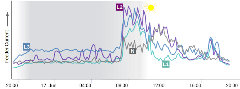

Let's consider solely the effect on the grid of just one house having solar export.
That must create imbalance because there will be decreased demand on the substation transformer for houses connected to that phase when grid export occurs.
A second house connected to the same local substation which installs a solar inverter with export has a one-third probability of being on the same phase as the first!
In the following timeline from a transformer supplying domestic properties, the solar export is only from houses on phase L1.
The period of sunshine starts at 10:00 on 17th June (a summer day)
The reason that the above substation losses can be withstood is because it is operating well inside its maximum capacity.
That is also the case for the 3-phase underground cable supplying the houses. I can see the cable size on the map in front of me.
Thermal stresses from the high current carried by the Neutral are probably still within the cable specification.
The random nature of solar export being assigned to phases means that losses due to phase imbalance are likely to increase until 10% of houses are exporting:
Stating that there are few PV installations in your neighbourhood conveys the opposite message to that which you might've intended.
Nothing here supports the case for UKPN having a high level of competency.

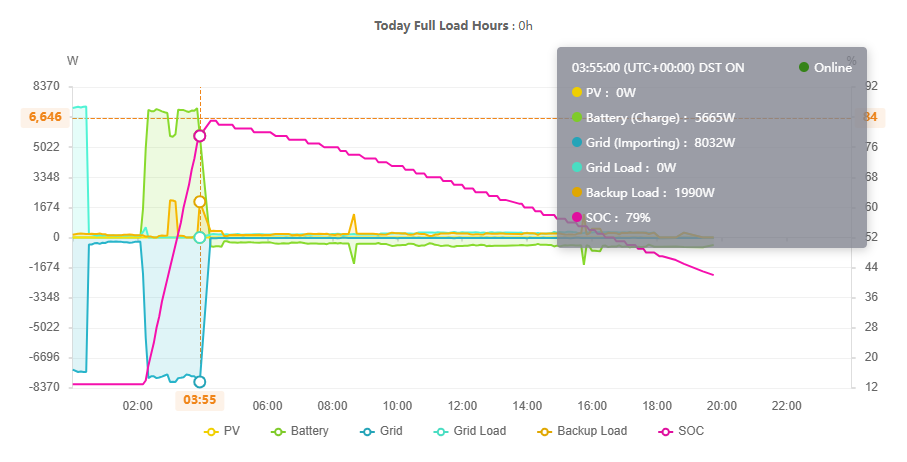

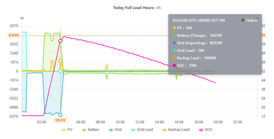

Solis AI is on the right track to leverage the battery:
It uses the grid when the prices are lower. Grid usage is negligeable otherwise..
