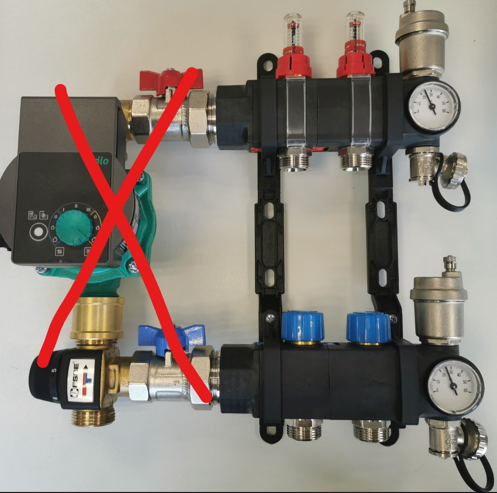

We have Windhager biomass at the moment, but installing UFH soon and would like to take the opportunity to prepare the system for upgrade to HP in future.Posted by: @andycoo
UFH is ideal to get max efficiency with a heat pump, but you need a properly designed UFH.
- Correct pipe spacing (calculated from heat loss) to deliver required power at low flow temp for high heat pump COP.
- Pipe spacing according to each room's needs so you don't have to raise flow temperature for the whole system (and nuke COP) just to satisfy one room.
- If a room can't meet design power with minimum pipe spacing, consider adding low temperature emitters like radiant ceiling.
- No mixing on the manifolds! Having the heat pump output hot water (low COP), then mixing it down to a lower temperature... that's the cardinal sin of heat pump design!
- This implies no circulator on the manifold, thus the pipe supplying water to the manifold must handle the full flow of all the loops on that manifold, and all that water flows back to the heat pump. Therefore... pipe diameter matters. Repiping is such a pain (I know, I'm doing it right now lol).
This means, when running on biomass boiler, if there is mixing, it should happen in the boiler room. So the whole system can take as input either 1) direct from heat pump or 2) mixed water from the boiler or tank. If you put the mixing on the manifold, then you end up with a bunch of three way valves and circulators which are useless with a heat pump.
If you have a thick heated slab it can be used as thermal store. In this case, you need even more flow. For example I have 10cm concrete slabs. So I got an oversized ASHP and run it during the day to profit off free electricity from photovoltaic and high COP. The gotcha is, since the UFH only operates about 50% of the time at twice the power, the pipes must be sized for that.
If it is retrofit UFH with thin mortar, there's not so much thermal storage so this does not apply.
Also consider DHW.
