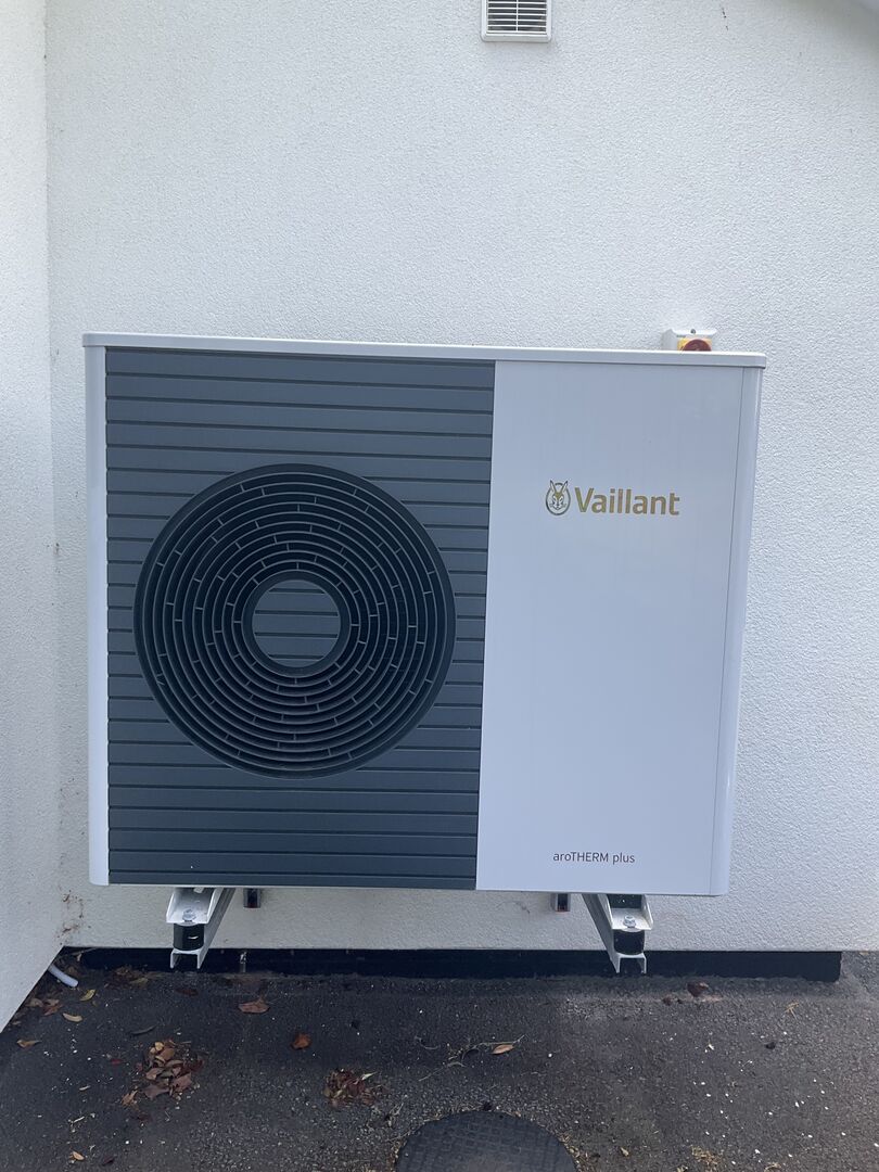

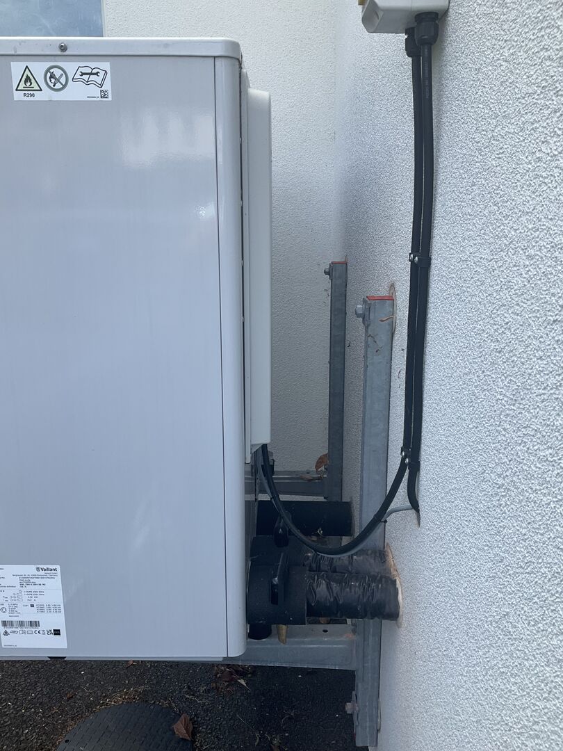

Our 7kW Vaillant is wall mounted, no problem neat installation, noise minimal. It’s on the Vaillant recommended brackets. It’s not absolutely simple in our case since the wall in question is externally insulated so you have to use the right brackets.
It’s on the workshop wall away from the lounge but can barely be heard in either the workshop or the adjacent utility room room.
@rob-heatpump-bob, if you have no option, then go ahead with wall-mounting, and it just involves a detailed conversation with your installer to take all steps to mitigate vibrations. Dramas usually occur when no provision has been made to fit anti-vibration mounts and 'absorbers'. Once you've had a chat with your installer, let us know what he says and we can advise you accordingly.
@judith, if you get a chance, please can you take a photo of the brackets. Would love to see how they look.
