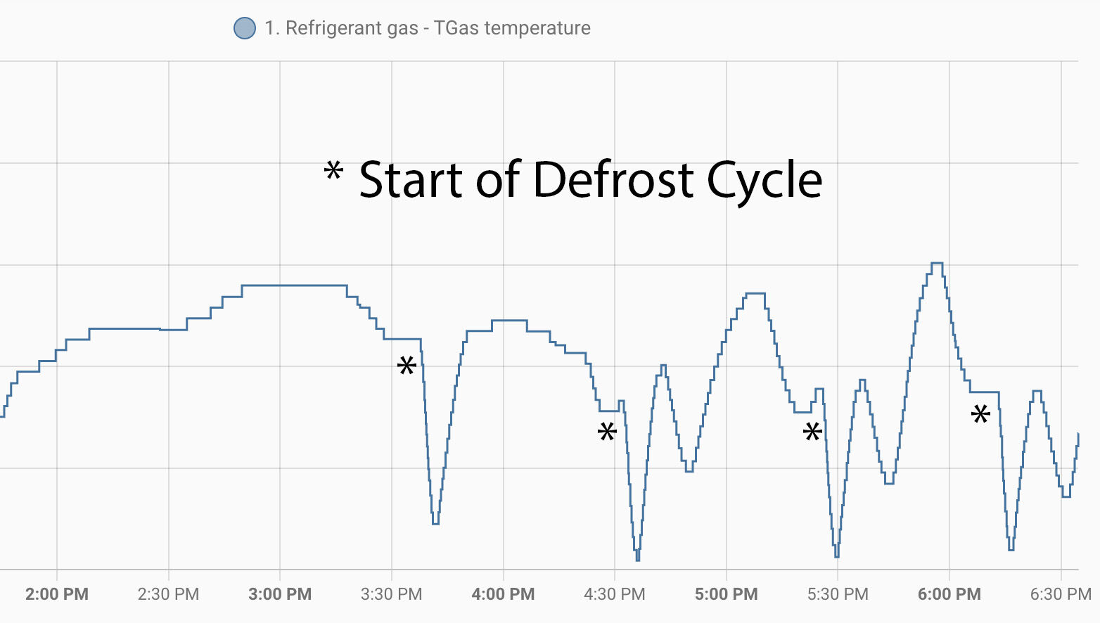

The Thermal Off is where the temperature into the heat exchanger is too high and it shuts down because the water is too warm.  Others would call this short cycling, Thermal Off is manufactures expression.
Fully open 12 port manifold.  12 thermostats in rooms but one one being currently being used, and that I turn off and on.
Unable to run 24/7 as per this morning and the thermal offs.
After a defrost the temperature never goes back to it's set level, it cycles up and down,  I have attached a chart which shows what happens on the 1st defrost and then the subsequent ones.
I have spent the last year trying to get to grips with this system, unsuccessfully.
My main reason for wanting to change is that it requires too much daily management to maintain a steady temperature.  You always need to be looking ahead at the weather to see what you do.

Re the chart.  I should of added more info.
The first part of the chart shows the performance during the day with one defrost occurring at 3:40pm. (I have a temperature probe attached to the refrigerant gas pipe coming into the indoor unit so it gives me an idea as to what the heat pump is doing).  You will see that the temperature falls and then recovers to a steady temperature.
The second part of the chart shows the subsequent defrosts occurring approx. every hour, as denoted by the *.  But when the defrost is over the temperature of the refrigerant gas does not achieve a level state, if fluctuates up and down till the next defrost.  During this time the house cools, as the heat pump is not producing as much heat.  While this is occurring the heat pump is constantly running at 52Hz with a consumption of 5 Amps.
Not running weather compensation at the moment (that's another issue), just a fix temperature of 31C.
Whatever you are experiencing in terms of house temperature is not, IMHO, going away 'simply' by getting another heat pump, and is likely to get even worse if you were to go to a boiler because it will cycle even more (because it will be even more oversized).  That's not saying that changing heat pump is not eventually sensible, but it wont magically fix the 'problem'
You have a very low loss house with a (relatively) high power heat source and are controlling it on the thermostat.
Thats like trying to drive at an average of 20 mph by alternating between 60MPH and 0mph, but only deciding to when to change between the two by looking in the rear view mirror to decide how far you have gone before reacting and then slamming on the breaks when you realise you have gone too far.  Its going to be a bumpy ride.
If you change to lower power heat pump 60MPH may become 40MPH, but its still going to be bumpy.  If you change to a boiler 60MPH is likely to become 80mph!
  • Have you got any plots of flow temperature and house temperature, not worried about refrigerant temperature - thats for the heat pump to sort out
  • If its not set to operate 24*7 what is it set to do?
  • when you say the house cools, by how much.  You shouldn't notice if the pump is off for an hour, assuming the slab has warmed up (perhaps that's the underlying problem) because of the vast thermal reservoir the slab represents
  • have you tried to set up weather compensation and failed/abandoned, or have you never set it up.  This is mechanism built into your heat pump to look ahead to see what the weather is going to do to your house thus saving you from having to do so!  With low loss and UFH this becomes vital, because control on room temperature alone is almost guaranteed to fail!
