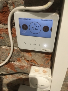

I would like to reinstate this thread please as Im going to try and sort out a friends LG heat pump. Could you just check what I think I have gleaned so far.
I can get into the SETTINGS menu by using the ver number as the password.
Select Temperature sensor: I can select 'Air+Water' if the thermostat is in a sensible position otherwise just 'Water'
Air Heating Set Temperature: ? Not sure what these do
Water heating Set Temperature ? Not sure what these do
LWT Temperature for Auto Mode: WC curve temperatures
Outdoor Temperature for Auto mode: WC OAT temperatures
After finished in SETTINGS, go back, then into the FUNCTION menu and set
Water Temperature Setting- Heating Temperature Setting to AUTO
Then go back to main screen and set heating to AUTO.
Their house should be idea for a heat pump as its got a big slab and UFH but its costing them a fortune to run at the moment. Just want to be sure I have it all sorted in my head before going over.
Thanks in advance

Posted by: @bontwoodyI would like to reinstate this thread please as Im going to try and sort out a friends LG heat pump. Could you just check what I think I have gleaned so far.
I can get into the SETTINGS menu by using the ver number as the password. 👍
Select Temperature sensor: I can select 'Air+Water' if the thermostat is in a sensible position otherwise just 'Water. 👍
16/25
Only works if using controller as your thermostat. Home shouldn’t go below 16 or above 25c.
20/55
Water heating will run between 20c and 55c when it needs to resolve it’s curve/heat (e.g. the heat you want)
I use 29/48
LWT Temperature for Auto Mode: WC curve temperatures 👍
Doc suggests 30/50.
Outdoor Temperature for Auto mode: WC OAT temperatures 👍
Doc suggests 3/15 . If possible tweak lower if house warm enough. E.g-2i use -4/15
After finished in SETTINGS, go back, then into the FUNCTION menu and set 👍
Water Temperature Setting- Heating Temperature Setting to AUTO 👍
Then go back to main screen and set heating to AUTO. 👍

@tim441 Thanks Tim, I think its been set to a constant flow temperature of 54C looking at a photo, so it should make a massive difference to their bills 🙂

@bontwoody yes, that is shocking!!
Depending where you are hopefully it will run at under 40deg much of the time. Right now its 8deg outside here... LWT is at 38deg.... and house a comfortable 21deg.
Saving elec as well as better efficiency. I would not be surprised if savings 25 to 30%
Fyi I'm now on Octopus Intelligent Go tariff as I also have batteries and EV. import price for 2025 averaged under 10p kWh
I guess they can currently feel the heat in the floor. With AI and lower temps the floor may hardly feel warm! But should keep a very comfortable room temp all the same.
