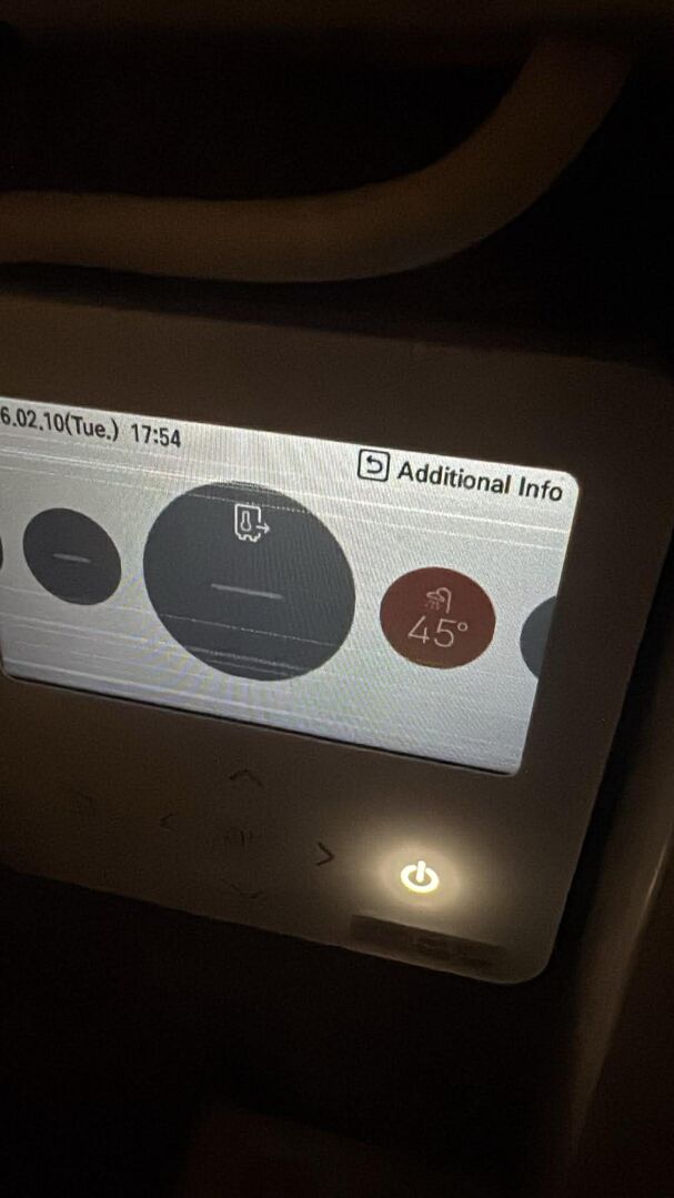

@tim441 So I havent been over yet, but apparently its not showing that screen now. Its showing this. Does this mean the heating is off? Thanks

@bontwoody yes.
Are they using external programmers and/or thermostats? Was it a retrofit for previous gas or oil central heating system?
Or have they set schedules in the LG system?
With AI you should run 24x7... and thermostats higher than requirement- especially during setup. Preferably long term too

@tim441 I think they have schedules set up as they said it was too expensive to run 24/7, but that was off course at 54C 🙂 Ill set up a WC curve for them at a sensible slab temperature. Thanks Tim

Yes, remove schedules for now anyway.
Hopefully you can look at tariffs too. You may be able to get a decent setup using Octopus Cosy or Intelligent ... and tweak schedules to maximise benefit.
But personally I'd focus first on 24x7 AI... then tariff... then further tweaks
