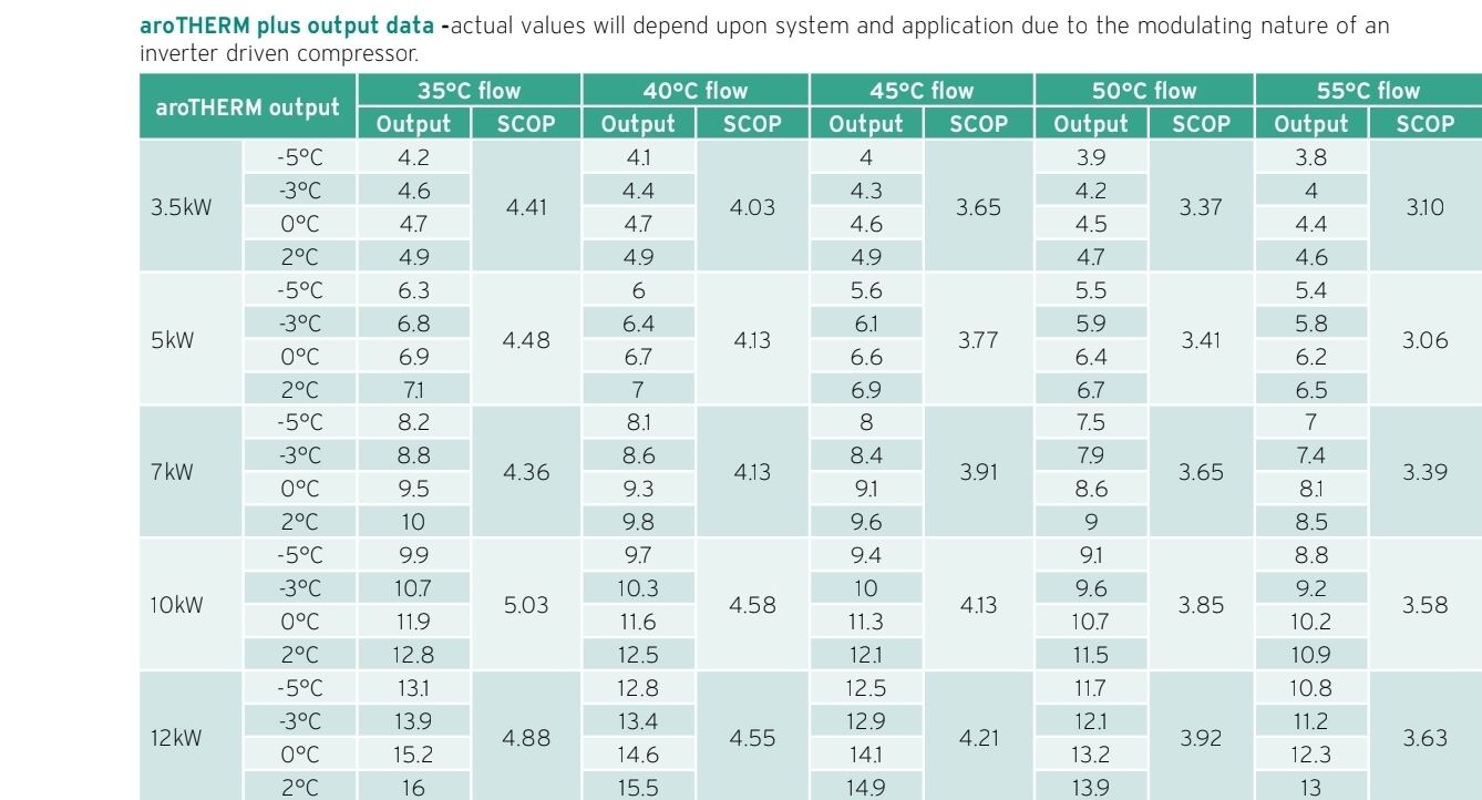

Screenshot 20261008 112325 My Files
@l8againagain I think you need to look into it in depth.Heat geek proposal says the heat loss are for -3.6 deg C outdoor and 21 deg C indoor temp
Vaillant spec for 5kW attached shows the unit can indeed do 6.4kW (my heat loss according to heat geek). But they can do 6.4kW at -3 deg c only if flow temp is 40deg C or below.
My existing T11 radiators cannot output 6.4kW at 40deg C.
Not overthinking here. My exisitng radiators wont work with 5kW unit from Vaillant for 6.4kW heat loss
@jo2255, you’re absolutely on the money here IMO. This isn’t overthinking it... you’re simply checking whether both sides of the design work at the same time, and this is something honestly makes my head hurt.
The Vaillant table you provided shows the 5kW unit producing 6.4kW at -3C only when the flow temperature is 40C. Your design temperature is actually slightly colder at -3.6C, so even that operating point looks marginal. Once the flow rises to 45C, the available output drops to 6.1kW, then to 5.9kW at 50C and 5.8kW at 55C.
Meanwhile, your radiators cannot emit the required 6.4kW with a 40C flow. Based on the figures you previously posted, a conventional radiator correction calculation would put their combined output at only a fraction of that figure. They would appear to need a flow temperature somewhere around the high 50s or 60s to meet the stated heat loss, but at that temperature the 5kW Vaillant no longer produces the required output. That is the gap that I think needs explaining.
Heat Geek may believe the calculated 6.4kW heat loss is substantially higher than the house will experience in reality, and they may have enough installation data to support that judgement. That is possible, but if the proposal states a 6.4kW heat loss at -3.6C, I think it is entirely reasonable to ask how the chosen heat pump and existing radiators meet it. The headache is getting stronger.
People/installers will also understandably point out that we only get a limited number of days at the design temperature. That is true, but those are precisely the days when the design really makes a difference IMO. Trust me, from experience, an extended cold spell is deeply unpleasant when the heat pump cannot replace the heat the house is losing. The temperature gradually slips, the heat pump runs relentlessly, defrosts and hot water cycles take more capacity away, and increasing the flow temperature in an attempt to catch up can cost a small fortune without necessarily restoring comfort. A fortnight of that in January feels considerably more important than its small percentage of the year suggests. Just speaking from experience having had a unit that couldn't deliver the required heat when we dropped below zero.
This is also where the guarantee’s fine print re-enters the picture. A good annual efficiency figure does not necessarily prove that every room will remain comfortable during the aforementioned coldest fortnight. I would want Heat Geek to confirm in writing that all the intended rooms will maintain their specified temperatures at -3.6C, including the effect of defrosting and hot water reheating, while still meeting the promised efficiency. I would also ask what happens if comfort can only be restored by increasing the flow temperature and that then pulls the annual efficiency below the guaranteed figure. The guarantee could still make this a very good consumer proposition, but it needs to guarantee both outcomes together... a warm house during the design conditions and the promised efficiency over the year. One should not be achieved at the expense of the other IMO.

@jo2255 — I agree with @editor, you are definitely not over-thinking this. There is a mismatch between apparent heat loss and apparent capacity. I say apparent because most if not all of the numbers are estimates. Even the aroTHERM data sheet says as much. But on the face of it, there is a mismatch, and it needs to be dealt with.
Given my recent post about MCS requirements, I am sure @jamespa is correct when he says Heat Geek are 'winging it a bit'. To my mind, there is just too much black box stuff about it, too much don't worry, the guarantee is there if you need it. But what is that guarantee? According the Heat Geek website it is:
