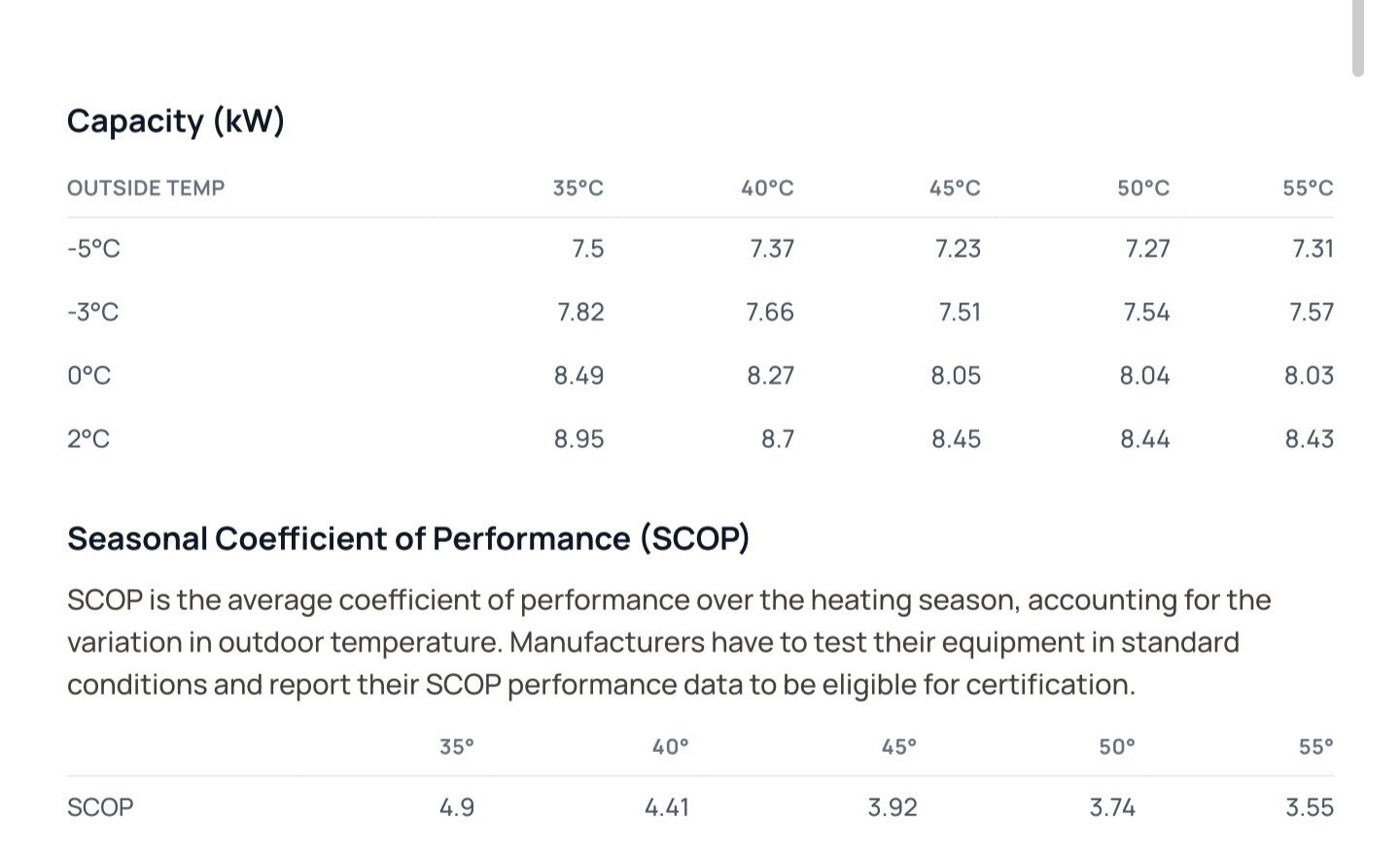

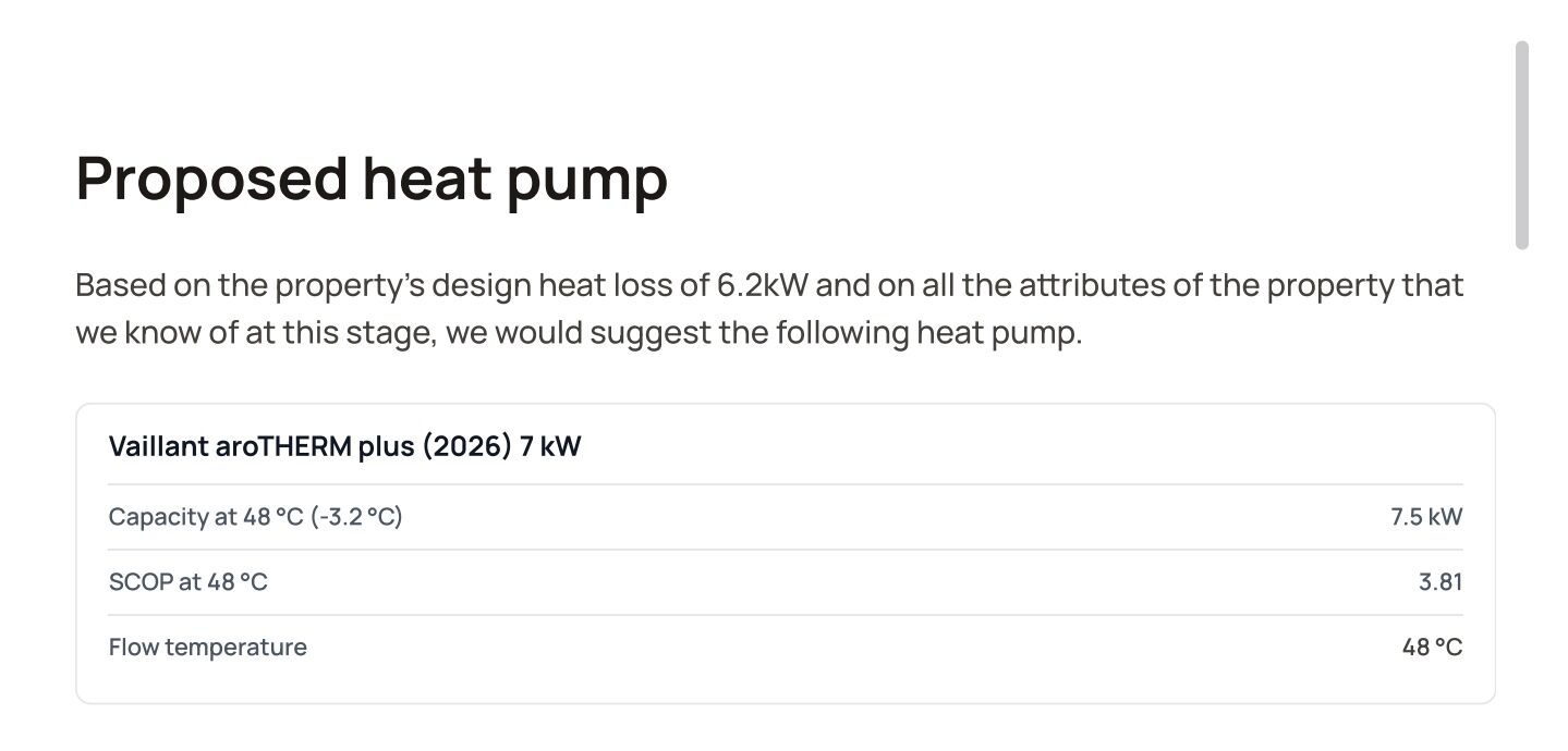

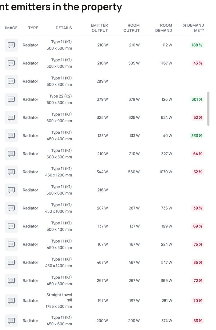

Also I had detailed heat losses with design flow temps, heat pump outputs etc from every installer except heat geek.
My heat geek installer sent theie own quote through Spruce where the info is clear about heat pump sizing, radiator sizing etc through Spruce.
