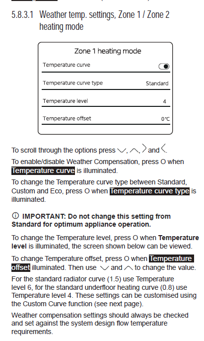

I would try to avoid that TBH as its creating unnecessary resistance.  Can you remind us whether you have the R290 or the R32 model?  I think that on the R290 you have to change the Temperature Curve type to 'Custom' (and presumably then the additional parameters appear), see screenshot below.  From a quick look at the R32 manual it doesnt seem to have this feature, but it may be possible to simulate it using the 'parallel displacement' function

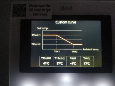

Here is the page where I have to input numbers..
17706641161315773171635529324136
I'm just not sure what to put in to get halfway between curves 4 and 5, below
Curve instructions 2
are you trying to programme your own WC to be between 4 and 5?

@ashp-bobba yes if possible, 4 defo too cold but 5 seems sometimes too warm. You can see the differences in the curves are fairly large at the lower temps. Any idea how?

14074 Curve instructions 2
if you find this to warm in the colder in cold winter just reduce the 47 to 46 and so on, if you find it to warm when outside is spring 15Deg C reduce the 27 to 26 and so on. if you find to cold in either season do the opposite.
I made you a new black line at 57 thats in the middle of 4 and 5 and then 2 lines showing the external temp and 2 pink lines showing the flow at temp.

@ashp-bobba great thanks. So I could have just picked any two points in the cold and warm parts of the curves and done an estimate? And those parameters will automatically form a custom curve?

@cmartinbwmba Most work that you set an upper curve so our favourite on UFH is 40@-3 and 20@20 to start and then we tweak to design, there is a lot more that goes into it but this is a good start and work up or down. if on rads often we are 45@-3 and 20@20.
Example based on professional design:
If the design is 35 Deg flow @-3 then we set 35@-3 20@20, this creates a custom curve.
if you let me know if you have rads or UFH?
