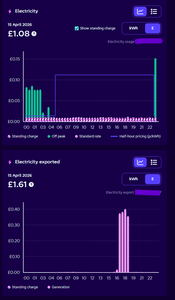

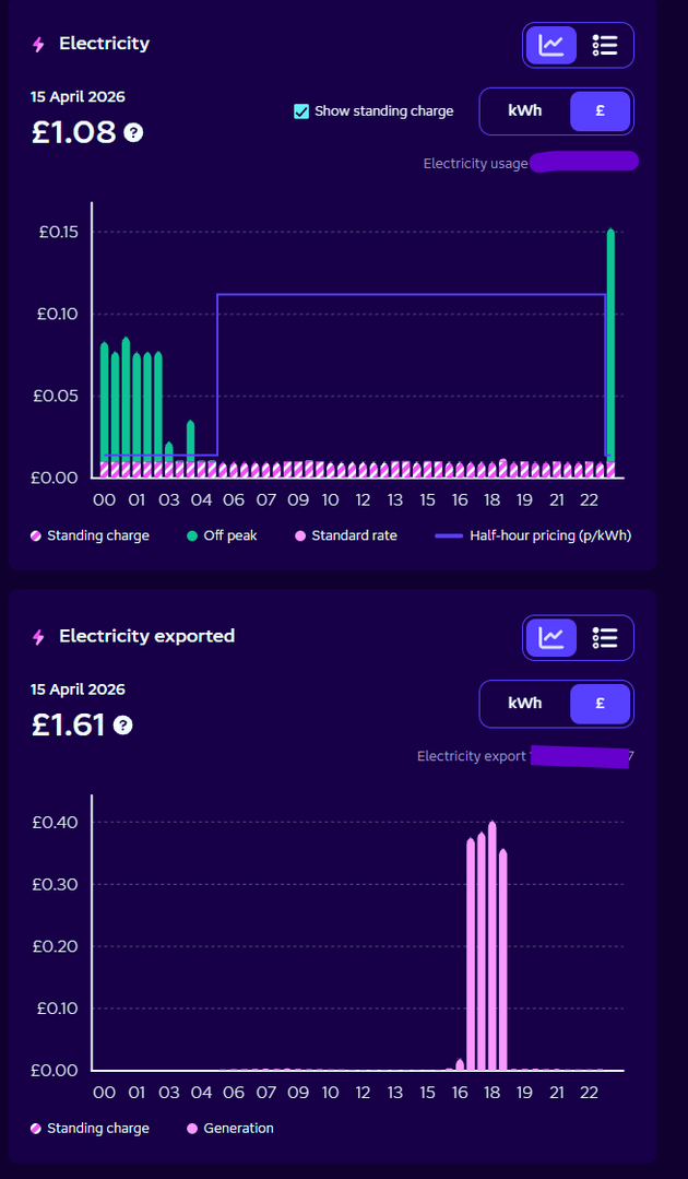

Our tumble drier is rarely running overnight. We never had issues and even if we have a battery, we did not change pour habits of running appliances and EV charging overnight. My bet is not all models are as likely to catch fire..
As for why, 3.5p/kwh overnight feels free. We have no PV but a full battery delivers more when peak time approaches.
