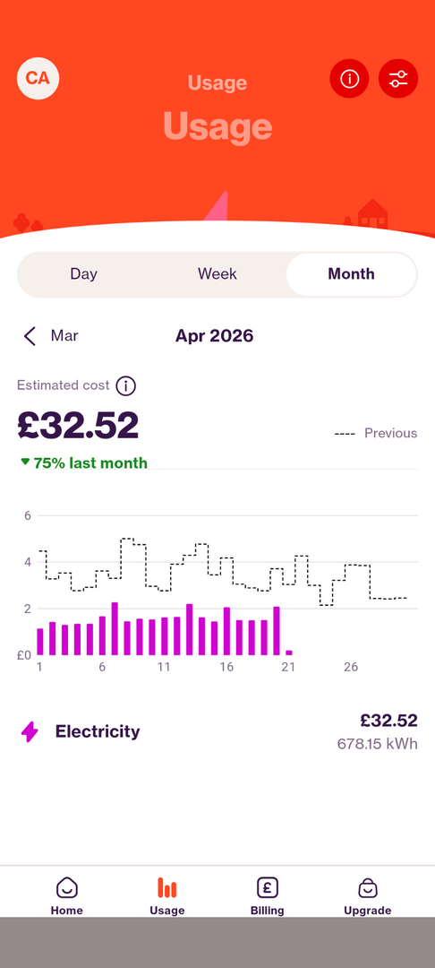

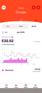

my octopus estimate for my 8kwh system on intelligent flux with octopus in addition you need to add in the units generated that I used myself the system costs me £76 per month interest free over 10 yrs and even without the export payments I make on average £24 pm average just in using my own generated power

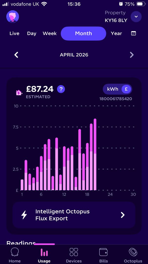

@majordennisbloodnok 12p per kWh? Octopus giving 20p and on intelligent flux when they use my batteries to export between 3-7pm I get 30 (which I usually have charged on SP
Posted by: @sapper117@majordennisbloodnok 12p per kWh? Octopus giving 20p and on intelligent flux when they use my batteries to export between 3-7pm I get 30 (which I usually have charged on SP
Yes. I'm on their standard tariff Octopus Outgoing which is 12p per kWh at any time. I've only got a 6.5kWh battery so don't have the capacity to generate during the day, export at peak times and service the house load at peak times too. The size of battery is the only regret we have with any of our original install (heat pump, solar PV, battery, inverter) and we are certainly now looking at ways we might justify replacing the inverter and battery with something like an 8kW inverter with islanding capabilities and a beefy Fogstar battery (e.g. the 64.4kWh IP65 unit at £6,000). It's a pipe dream at the moment but we're well aware we're already in a comfortable position as we are and can plan ahead at leisure.
