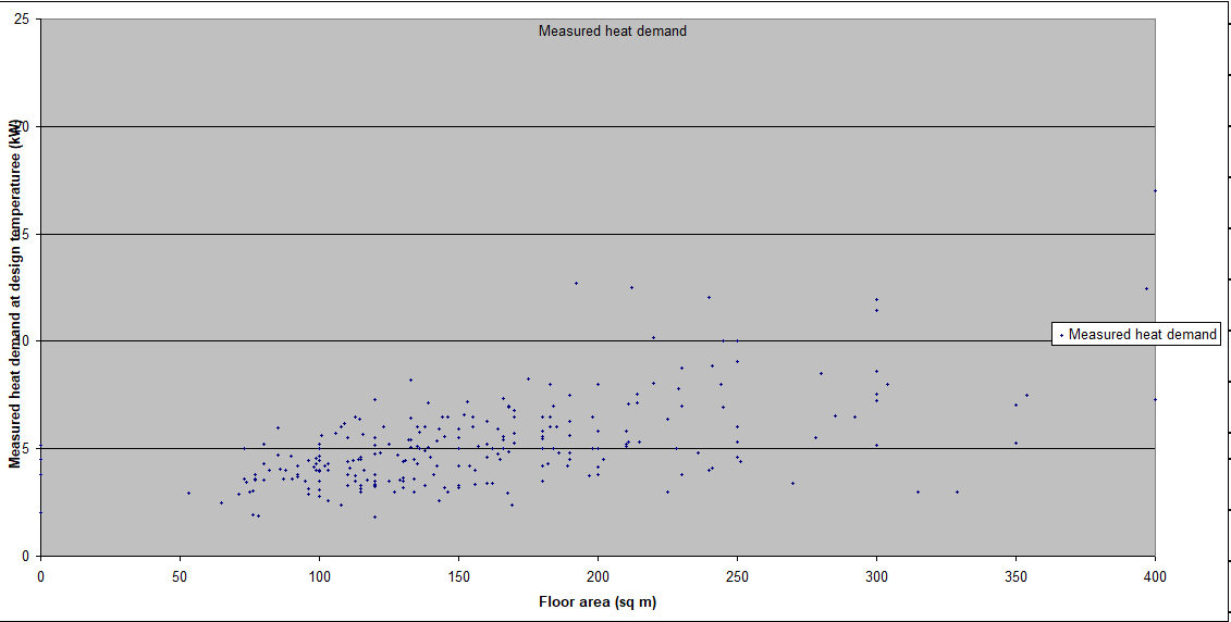

1. Is it right-sized? Oversizing heat pumps can be as bad as undersizing them; 10kW is a little on the large size suggesting wither the house is poorly insulated or its rather large. Below I reproduce a plot of about 250 systems from a popular heat pump monitoring site showing measured loss vs floor area. Its notable that there is only one system where both the floor area is <200sq m and the measured loss in >9kW
