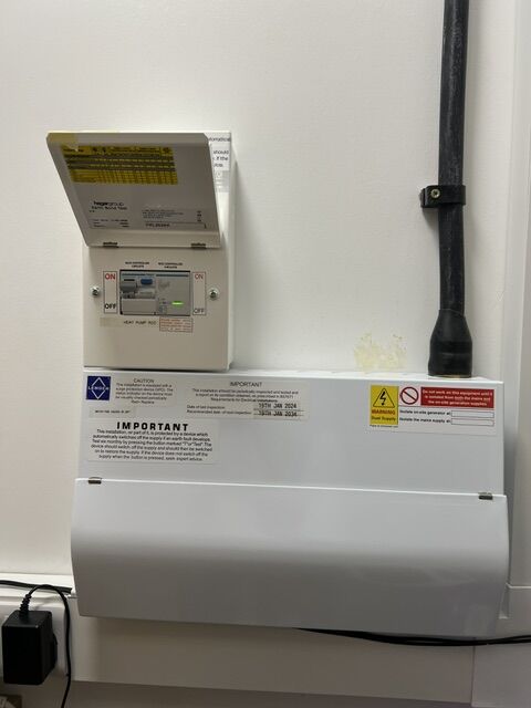

In my recent Vaillant install I had some lengthy discussions with my installer as to why I needed another consumer unit and this special RCCB from Hager.  I gave in at the end.  Added over £600 to my install costs.

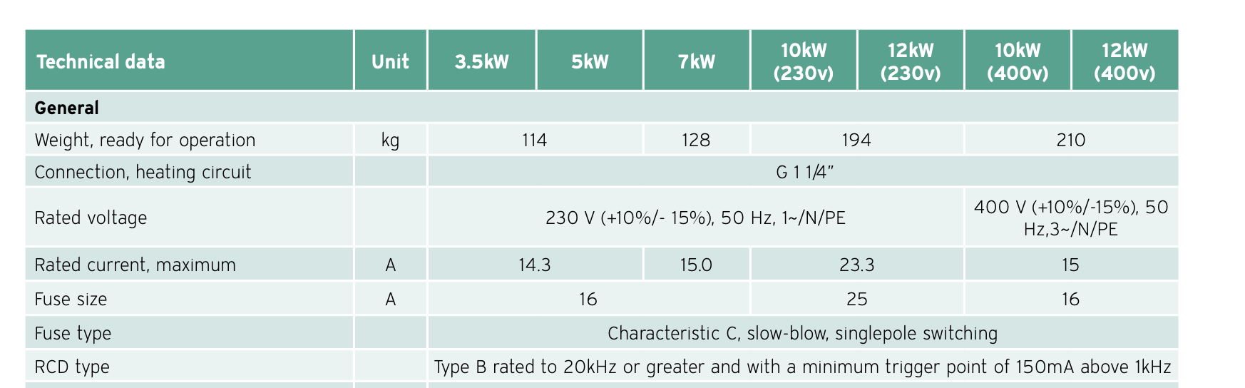

The requirement for me came from the following document.
Screenshot 2026 06 11 at 09.52.46

Although we can't see the part number on that photo above, I assume that the Hager RCD in the upper consumer unit is this one.
See the short-form technical guide which can be downloaded here.
As it's only an earth leakage trip, presumably there must also be an MCB in the main consumer unit which provides over-current protection.
Vaillant are specifying a Type-B earth-leakage trip in order for it to function when there is a DC-component being imposed onto the mains waveform.
And the additional 'HP' specification allows it to also trip-out when there are harmonics present above 1kHz.
That suggests to me that the Vaillant power supply is 'sub-optimal' in that it's imposing distortions onto the grid which shouldn't be there.
Harmonics (multiples of 50Hz) create losses on the grid, which is of concern to DNOs.
The symbol on the front of the Hager Type B RCD do not indicate the presence of a filter. Both the DC component and the higher frequency harmonics will pass straight through.
That raises the potential problem of those improper frequencies adversely affecting earth-leakage trips which feed other circuits from the same Consumer Unit.
I don't understand why the electrician working for @trebor12345 chose this particular Hager unit.
For about the same price, he could have bought a 1-module-wide RCBO designed and manufactured in the UK by Proteus.
That would seem to do the same job, and could've been installed within the existing Consumer Unit.

Posted by: @trebor12345
@trebor12345
Noted.  As I say the Valiant installation manual I have does not require an RCD, but does specify the type if one is fitted.
I would say that the document above could be read either way however if you read it as RCD mandatory then a fuse is also mandatory and hardly anyone is going to fit one of those.  Thus I would personally refer to the installation manual for clarification.

The current Vaiilant manual says the same as mine, IE it specifies the type of RCD if an RCD is fitted, but does not specify that an RCD must be fitted.  That latter decision is, by implication, left to the installer/local regs.
7.3 Requirements for electrical components
Flexible hose lines that are suitable for routing outdoors must
be used for the power supply. The specification must com-
ply with the standard 60245 IEC 57 with the abbreviation
H05RN-F as a minimum.
The electrical partitions must have a contact gap of at least
3 mm.
For the electrical fuse protection, slow-blow fuses with C
characteristics must be used. With a three-phase power sup-
ply, the fuses must be three-pole switching.
To protect people, type B universal-current-sensitive resid-
ual-current circuit breakers must be used if these are stipu-
lated for the installation site.
For the eBUS line, no lines with twisted wire pairs must be
used.
7.4

Posted by: @transparent
There is NO MCB in the main consumer unit for the heat pump.  The electrician took the feed for the heat pump straight into the new Hager Unit in the new consumer unit.  Are you saying that the new Hager unit still needs to be protected by a MCB?
