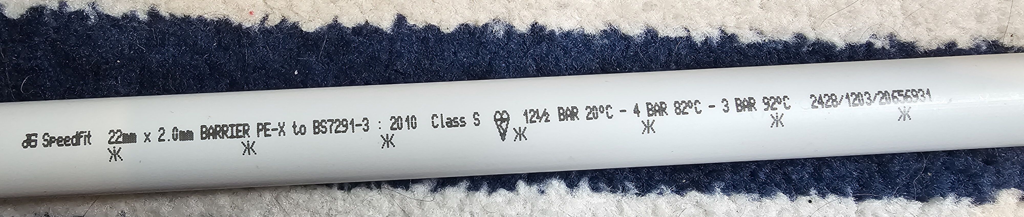

But I suspect somebody needs to check if there's a blockage somewhere. When you say 'PVC pipe' do you actually mean PVC (garden hose type) or PEX or Polybutylene? Both PEX and PB are rated for heating while PVC collapses when hot. If it's in HDPE (blue water supply pipe) then that's only rated to about 38C.

@prunusk
I guess I was being generic with PV The pipe is the below.
JG Speedfit WC22BPEX PEX Pipe.
