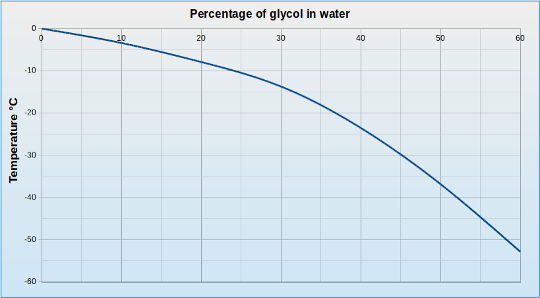

For the sake of others reading this topic in the future,
here's the classic glycol anti-freeze chart
GlycolMix2

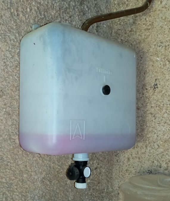

... and the Glycol I have in my solar-thermal circuit is pink! 😎
Here's the overflow tank with the dye still staining the inside.
