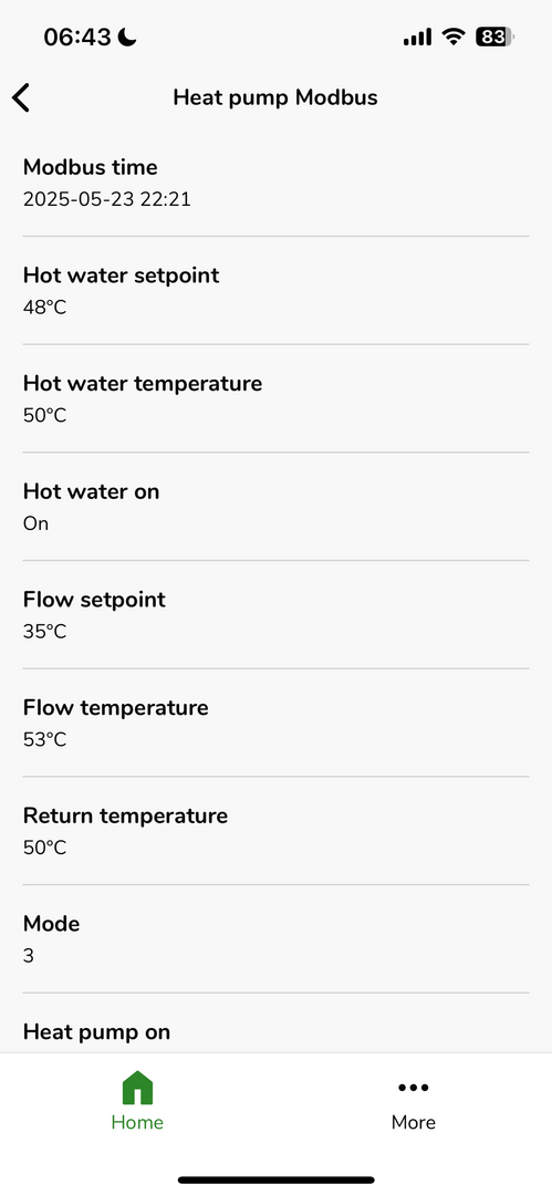

@el_presidente yes I have the installer app. Connectivity/system check is all coming back fine.
The heat pump modbus which should show a snapshot of current parameters clearly isn’t right and is stuck to a set point a couple of days ago, so this is why the graphs are displaying as they are. Looks like one for homely support…

Actually I might try just turning it off and on again….see if that sorts it.
annoyingly we’re away for a few days so will have to fiddle with it when back later this week.

Turns out this wasn’t anything to do with homely, and turning it off/on again. The problems escalated over the last day or two and turns out an external junction box and conduit entry hadn’t been installed properly. This has wiring connections for the cylinder temp sensor that were completely submerged in water that had been getting into the box. Luckily an easy fix once I’d figured it out.
