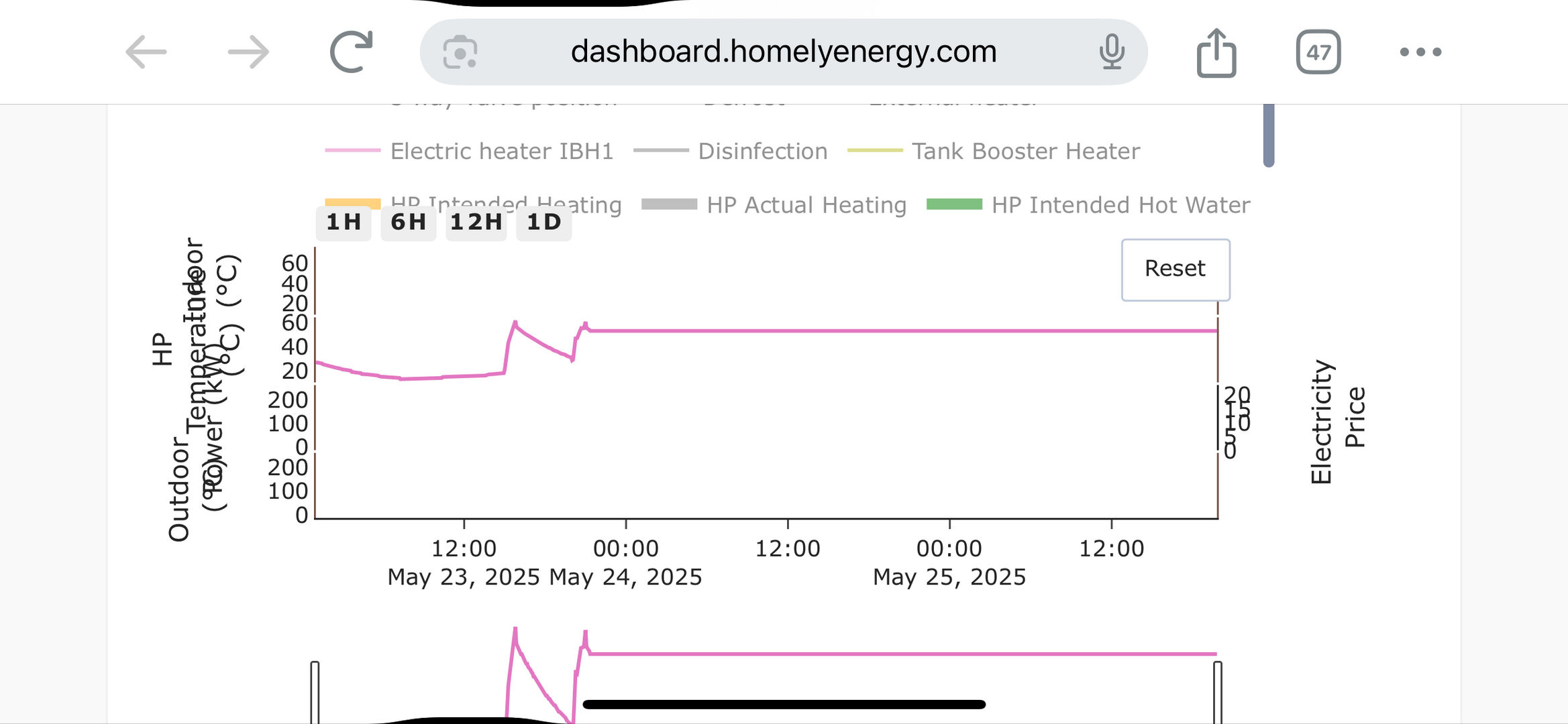

Is everyone else’s homely working ok? The last couple of days we’ve had a very odd fault. Everything seems to be stuck and flatlining. Flow temp at 53. Cylinder temp at 50. Our HW randomly came on at half one this morning which is nowhere near reheat time (and setting on app is to reheat during set periods, not pre heat). Also HW is stuck as permanently on, on the app…
(attached graph is flow temp)
IMG 4422
(@el_presidente)
Posts: 15
Mine is working as normal today, no issues. Do you have Installer/Connect access? If so, check the overview & connectivity area then the base stats that show current state.
