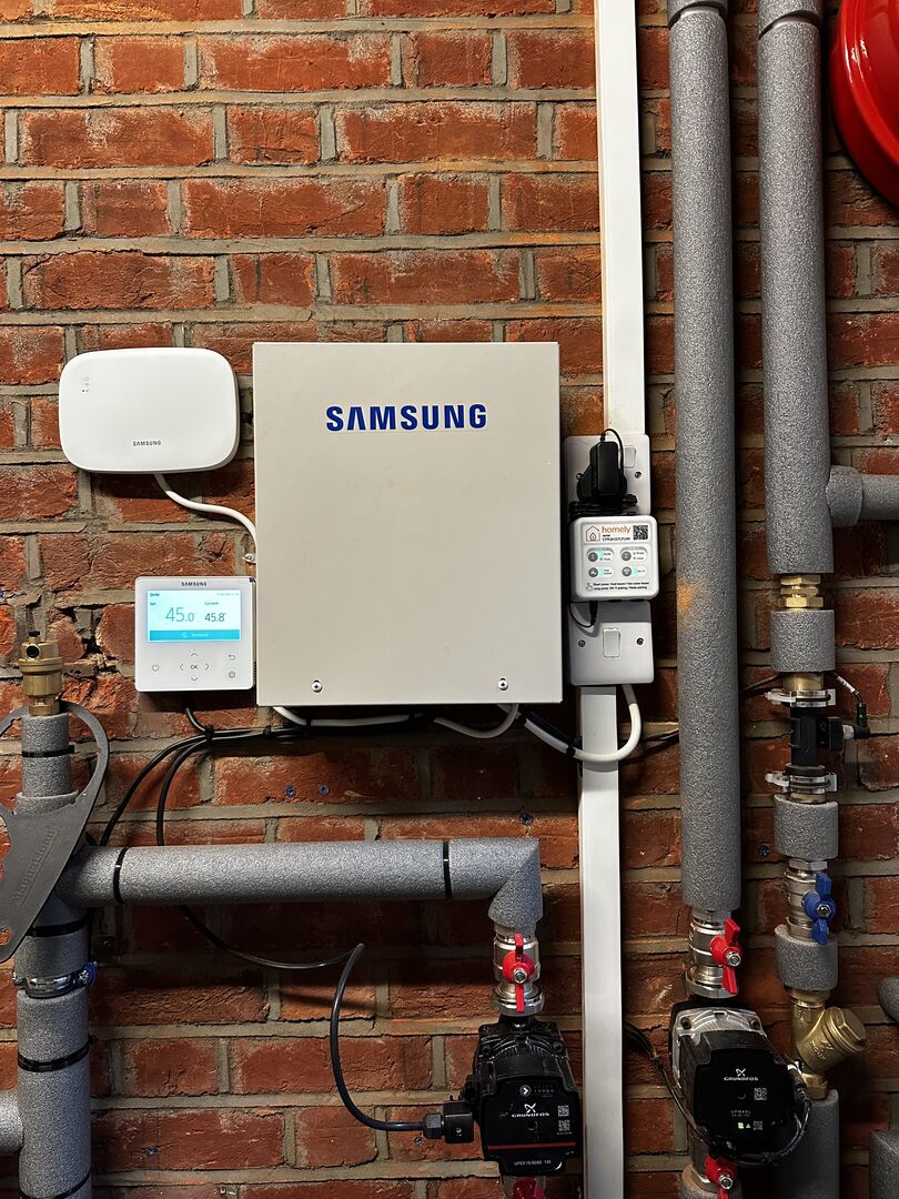

@old_scientist my installer put in a Homely Energy control box which controls all of the heat pump functions.
The Homely app is good and allows me to easily control hot water and heating schedules and temperature, plus holiday mode if needed. The only thing homely doesn’t allow me to do is get at the historic performance data, hence the need to still use the Samsung Display panel.
The energy usage data on the panel seems to be well organised with the ability to scroll through data by week (broken down to day) and by month. You can scroll back to previous periods using the arrow keys. I’m not sure if you have the same panel as me but if you do it might remove the need for you to take pictures every night.
I use their Homely Smart+ plan (about £25 per year) which optimises the ASHP around our off peak smart tariff periods. That and our battery storage (19kWh + PV 3.87 kWp) means so far the ASHP energy costs are very low. But I haven’t yet experienced a winter with it running.

Yes, I have the same Samsung controller panel as you. I take photos of the use and generation numbers daily, simply so I can then add these onto my spreadsheet, it's easier than pen and paper, and I'm at an age where I'll forget the two numbers in the time it takes me to walk from the control panel to my PC 🤣

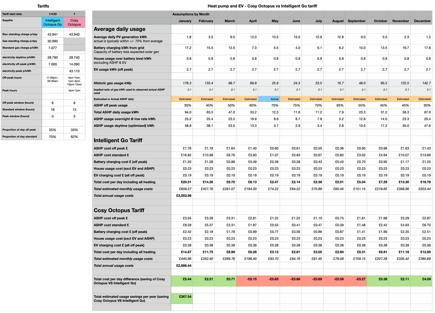

@old_scientist That’s really interesting that you switch between Cosy Octopus in the winter to a more favourable tariff in the summer. Just before having the ASHP installed I modelled the cost difference between the two with theoretical ASHP kWh consumption figures (I used our gas consumption numbers divided by expected COP) and that showed a £300-£400 net advantage for the year in using Cosy Octopus, versus Intelligent Go.
The model showed savings in the winter and extra costs in the summer. How do Octopus react to you changing twice a year? And how long does it take for them to make the transition?
So far, our actual ASHP consumption numbers are higher than I forecast. I think that’s because now we are heating the water for at least 12 hours per day, when previously I was trying to use minimal gas water heating in the warmer months. So I’ve no idea what the actual winter usage will be.
I’d be interested to see your typical consumption if you were willing to share.
You can see my model (and actual ASHP for May, and actual PV gen for all year) here attached. You said you are a spreadsheet person so hopefully this won’t be overwhelming. This model is calculating higher costs on both scenarios than our actual previous costs for gas heating, so I’m hoping the model is wrong and my actual winter ASHP energy usage will be lower.
If you have data to share then it would help me refine my model.

@grahamh-uk You can switch tariffs with Octopus instantly - I've switched back and fore a couple times between Cosy and Agile, and the switch is instant from the day you accept the offer by email.
Cosy worked well for us last Winter, with solar but no batteries. We shifted as much usage as possible into the three cheap slots. If you have batteries with sufficient capacity to last the 6 hour periods between cheap slots, then you could run totally at the Cosy cheap rate - this is our plan for next winter as we are currently seeking to install 13.5kW of battery. Our peak usage should be around 40-45kWh (hopefully never more than 50kWh) per day. Without batteries, our average import price last winter was ~19p
Without batteries, I've found switching to Agile once the heating season ends has worked out a little cheaper for us. The switchover point is the point where generation exceeds usage, which for us generally coincides when the heating goes off. Once we have the battery installed, IOF (or one of the cheap overnight EV tariffs) will also be a possibility. We use ~10-15kWh per day in summer, so a 13.5kW battery is about right for a days usage in summer.
I'm guessing for you, the moment you can cover your daily usage from battery + generated solar, that's the time to switch to IOG and leverage that 7p/kWh rate rather than the 14p/kWh on Cosy. Of course you only ned to cover 18h of usage as 6h overnight is at cheap rate anyway.
Wow - your DHW usage seems high. We reheat our DHW tank on a schedule, once per day. Do you do likewise, or do you have it on constant reheat? It's a lot more efficient to let it get as cold as possible and then reheat than to constantly top it up (if you have it on constant, try increasing the hysteresis). We heat our tank to around 45C and often it's dropped to around 30C (although still quite warm at the top) before we reheat. One reheat per day does us at present (which uses 1.2 to 1.5kWh), but that may increase as we're in the process of installing a shower which will be fed from the DHW tank to replace our electric shower. We schedule the reheat for early afternoon each day at the warmest part of the day (most efficient) and covered by solar on a sunny day, which gives fresh hot water for the evening meal wash up, and is still plenty hot enough for morning showers before reheating again after lunch.
