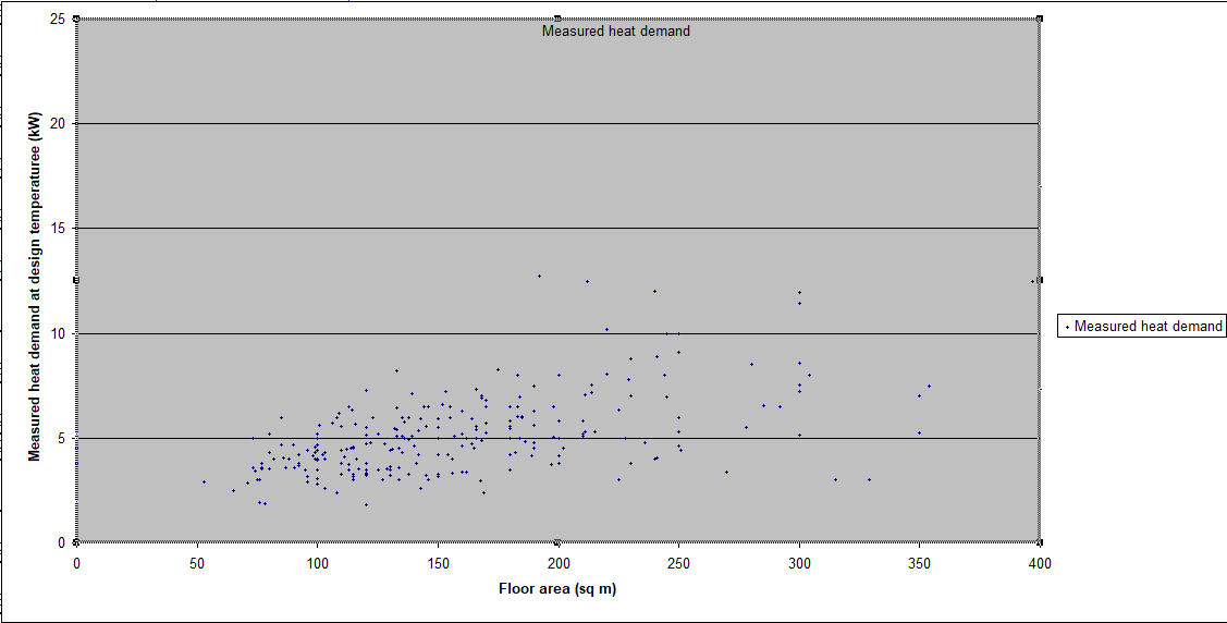

With 3 years on this forum, I am immediately suspicious whenever I read a surveyed heat loss greater than about 9kW, unless its for a mansion of a very poorly insulated (usually listed) building,. Of course it does happen but its rare, and more likely that the loss has been heavily overestimated.
Here is a scattergram from heatpump monitor of measured demand at design temperature vs floor area, taken from about 250 systems. I think this illustrates that I am right to be suspicious! Each spot represents a specific system, except in the dense area where multiple spots may overlap.
Conclude from this what you will.

There is onl,y one system currently on heatpumpmonitor that is both under 200 sq m and have a measured heat demand of >9kW at the design temperature. So if your house is really 11kW its an outlier by some margin; the highest measured loss recorded on heatpumpmonitor for a house your size or less is 8.3kW. An oversized heat pump is not necessarily bad, although it can be, but if the options to which you are being constrained are causing you a problem, then you may want to do some more due diligence.
