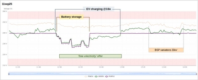

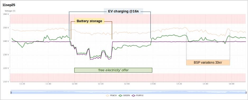

I already have sufficient (portable) battery capacity and a collection of off-grid inverters which would leave 'our' stand live 😉
You'd be surprised how little 'high power' demand you can put onto the local LV grid to create quite substantial voltage dips.
This shows the effect of adding one storage battery (4.2kW for 30mins) and one EV charger (3.6kW for an hour) to the grid during an Octopus Free Electricity hour.
FreeElec 11sep25
I included that diagram in a submission to DESNZ a couple of weeks ago. 😆
